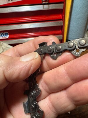

Here’s the cutters I did yesterday.
I use the bottom edge of the wheel to lower the rakers after the cutters are ground.
In the close up cutter pic you can see the chrome that peels up as the blade is ground. It snaps off on contact with wood and doesn’t seem to be causing a problem, I just wish it would go away. lol.
