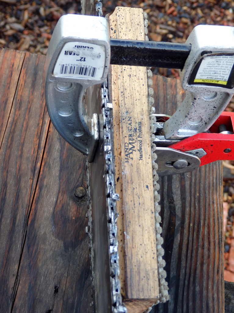

I really like JR's set up for stoning~Sweet. I stone chain on the saw-(chain mounted bass akwards). Here's some notes,A couple of pictures, and a short video. On the last one I did
Sierrawoodsman
10:49 PM
525
Jan 13, 2016
194
693
Dayton Nevada

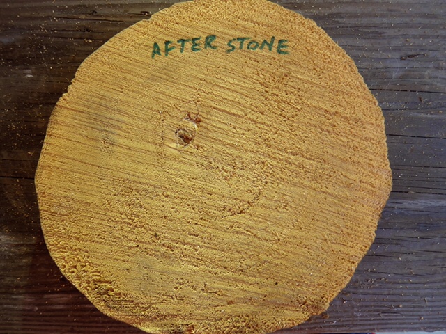

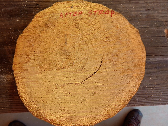

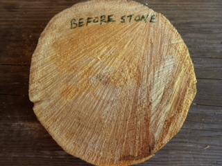

I've tried various types of stones for this part of the process and I have decided that I like to Use diamond lapping bench stone the best because it's perfectly flat, has fast material removal characteristics, and it doesn't wear quickly. Mount Chain on your saw in the running "backwards" orientation. Fairly tight chain tension. And mount the lapping plate with a .030" spacing plate so The lapping plate that it is in contact with one or two cutters, but not interfering with anything else. Then secure in place with a "C -clamp" or Quick release clamp. Use start and stop motion to keep heat down. The goal here is to square up the cutters "working corner" by removing material from the sideplate, this also reduces kerf width which therefore, reduces the load on the chainsaw. Stoned surface should extend no more than about .100" or so beyond cutting edge. Excessive stoning can reduce kerf too much and cause the chain to bind in the cut. This part of the procedure is probably the most dangerous to do. Proceed at your own risk!
Perhaps a safer/slower way of doing it is to use that same diamond lapping plate and perform this operation by hand with your chain mounted to your bar or chain vice and securing it firmly in place. A properly stoned chain will have a much smoother appearance to the end grain of a log.
Top view:
Reference the surface of the cookies below.
All were cut with the same chain on the same saw with the same Raker setting.The only difference being the amount of stoning that the sideplate received.
Notice the final cookie appears almost "sanded smooth" in spots. This was after leather honing. See video below:

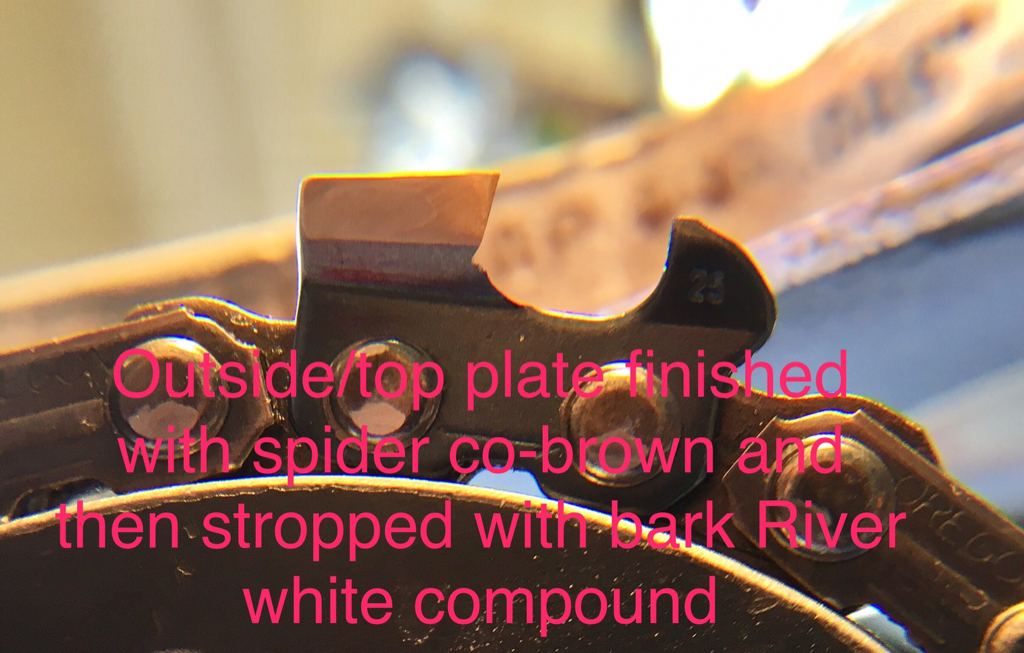

Hope that helps. That's just what I do. You have to find a method that works best for you.
On a side note, I have also found that it is sometimes necessary to touch up and working the corner slightly after stoning the side plate. Here's a close-up View of one that has been stoned and honed.
