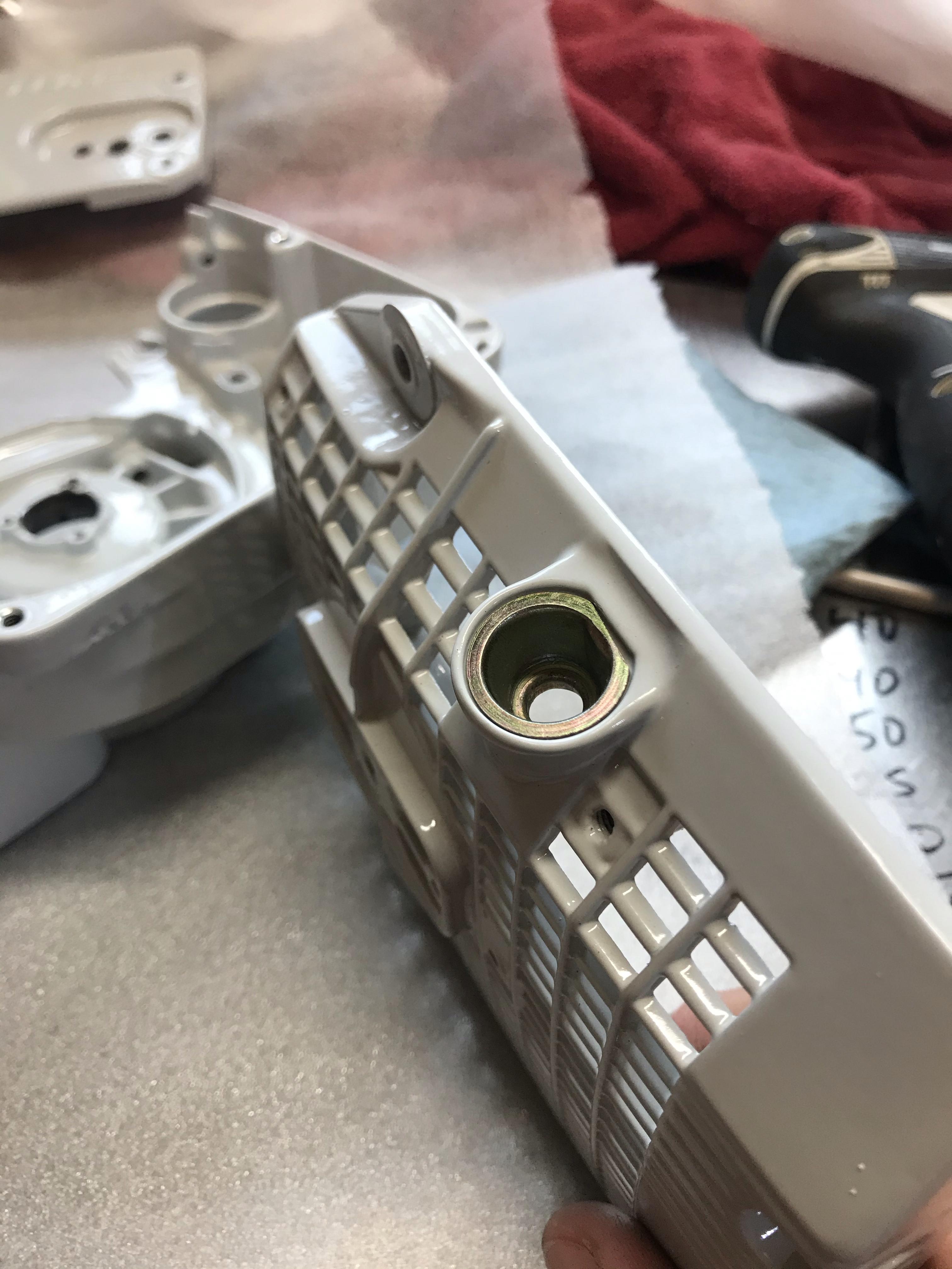

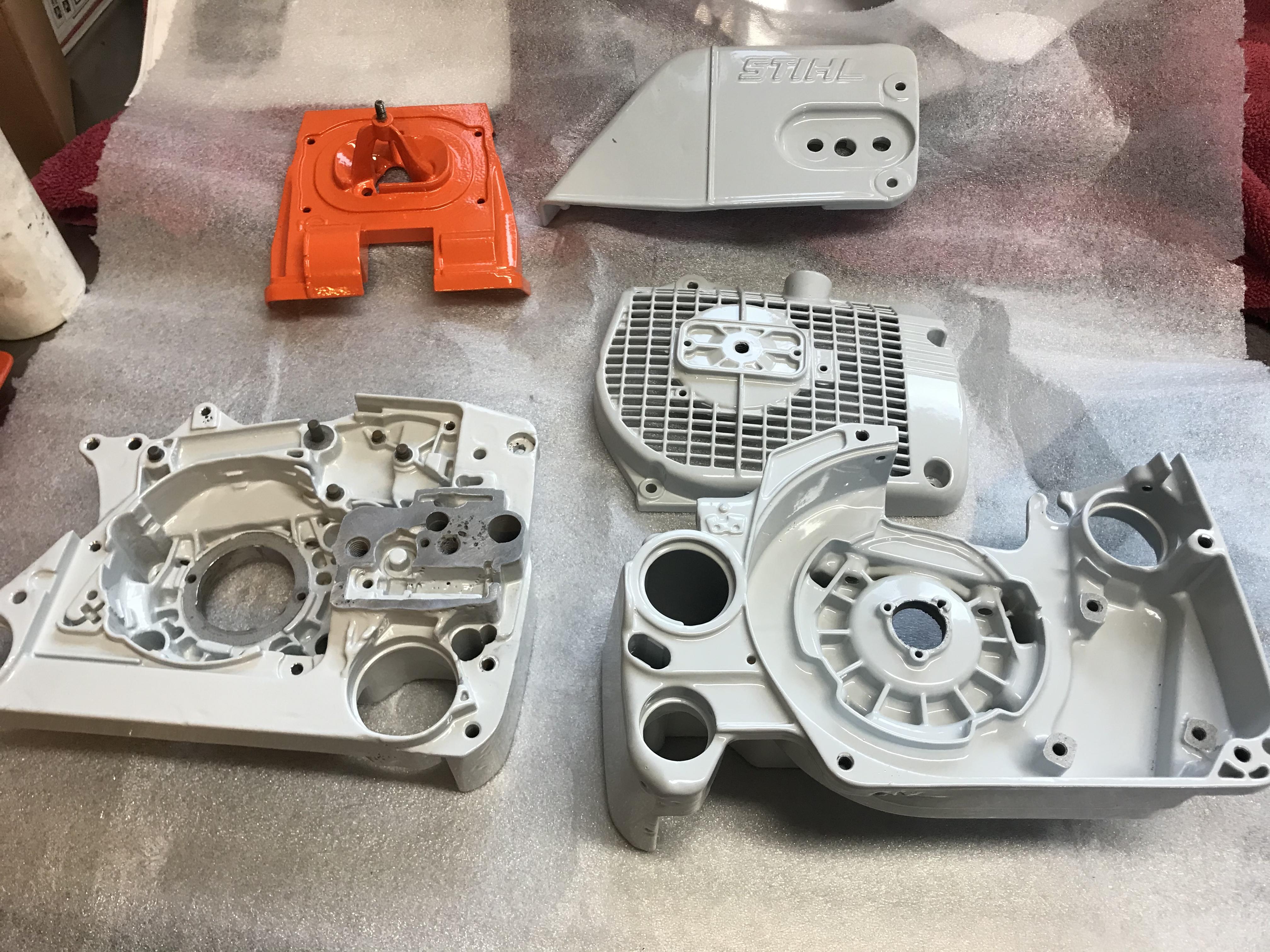

Parts are back and looking good as usual. Time to get to work on assembling this thing. I might have to order a new recoil axle and spring if I don’t have them around. Mike even put a new thimble in the starter cover.
Mike shared the proper tools to replace those with me a few years ago. I've used them a lot more often than I thought I would.
Same here. Anyone wrenching on older Stihls should buy that tool or fab one up. It almost looks like a small tapered air fitting and bushing could be made to work.

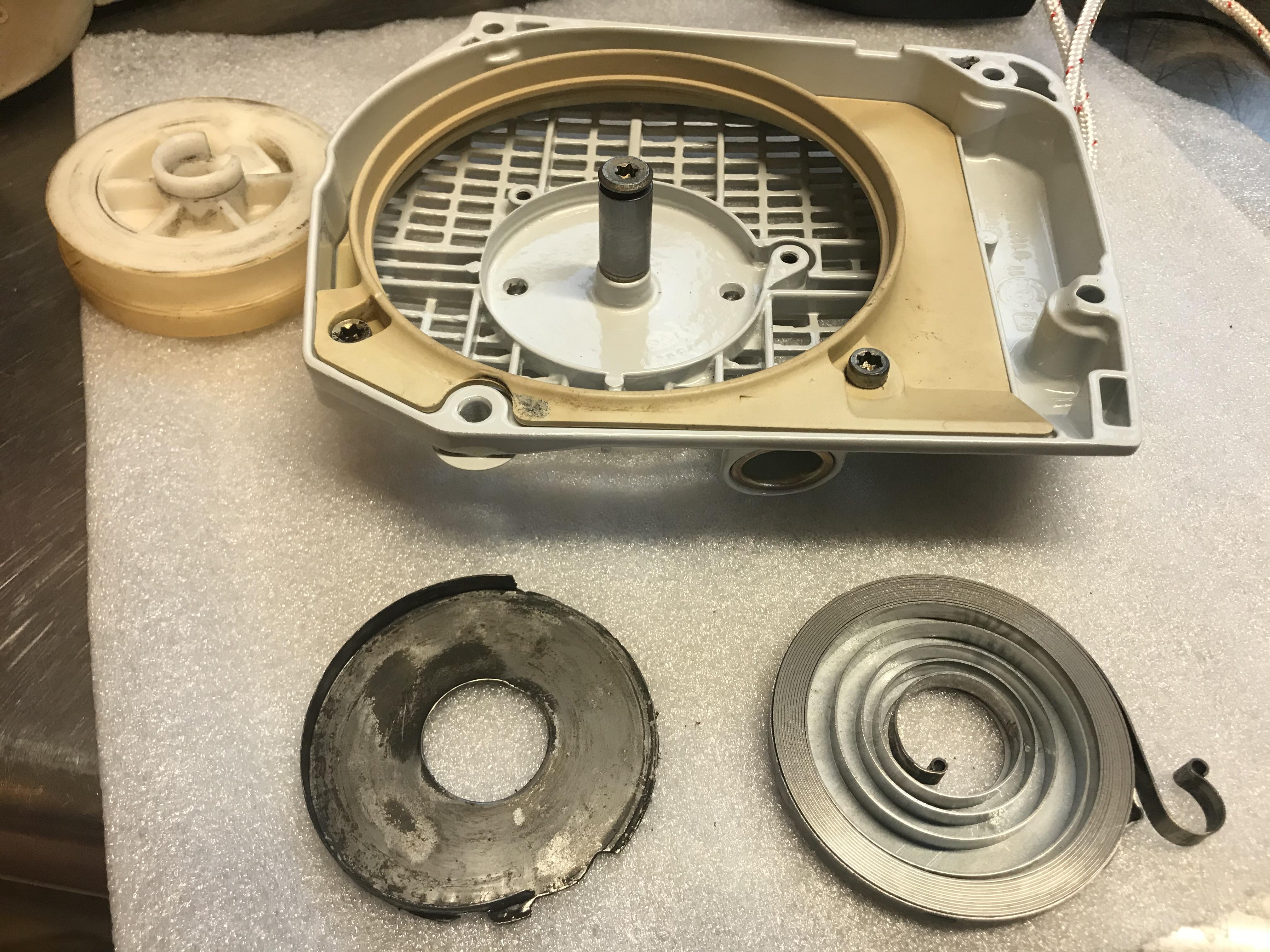

Finally piece is here. The spring was ok but the metal cup was broke. If you keep running them that way they wear through the starter pocket. It seems you can’t buy just the cup so I buy the spring and cup combo and drop it in.
New starter axle is a late model 660 style, they work fine but you’ll also need the larger inside diameter washer to go with it.
