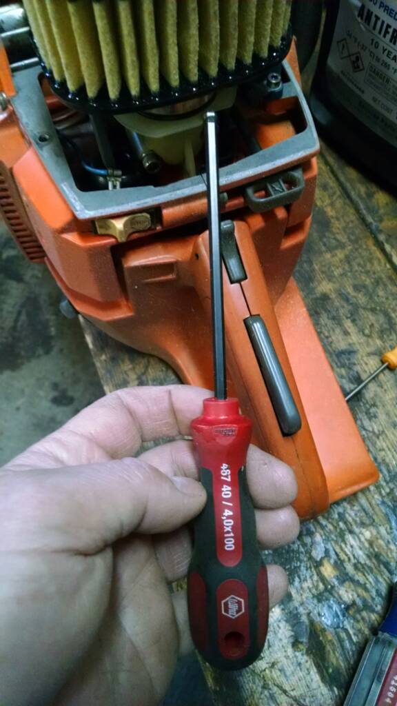

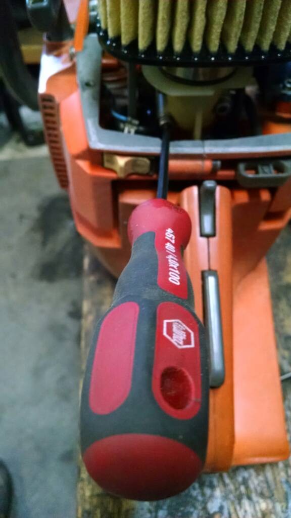

Btw. What’s your trick on getting the lower carb bolt out. I shortened a standard Allen wrench, but it’s a pain in the ass. The ball end style doesn’t clear the case.

Without pulling the top end a real short Allen was the best way I figured out.

Here's what I use on the carb bolts. My cylinder is cut so the bolts sit a bit lower than stock, no issues.
