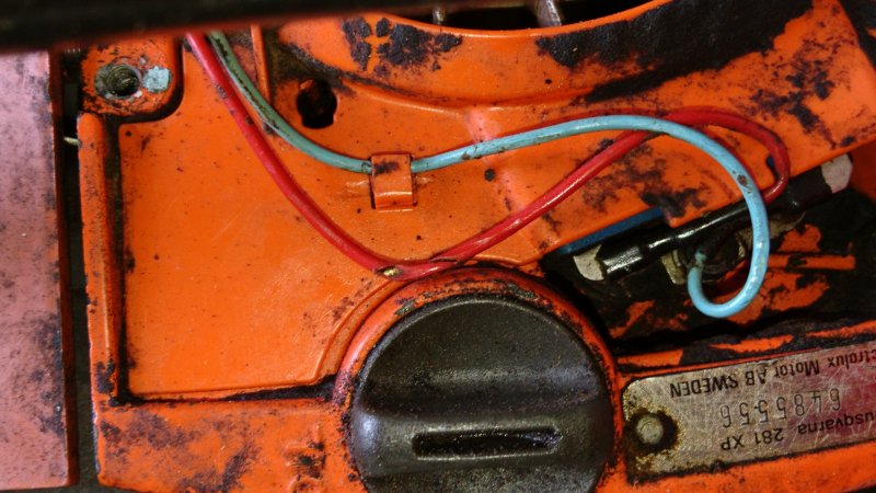

I looked at my 281 project yesterday...does that count?
I need to rewire mine.... blah...
