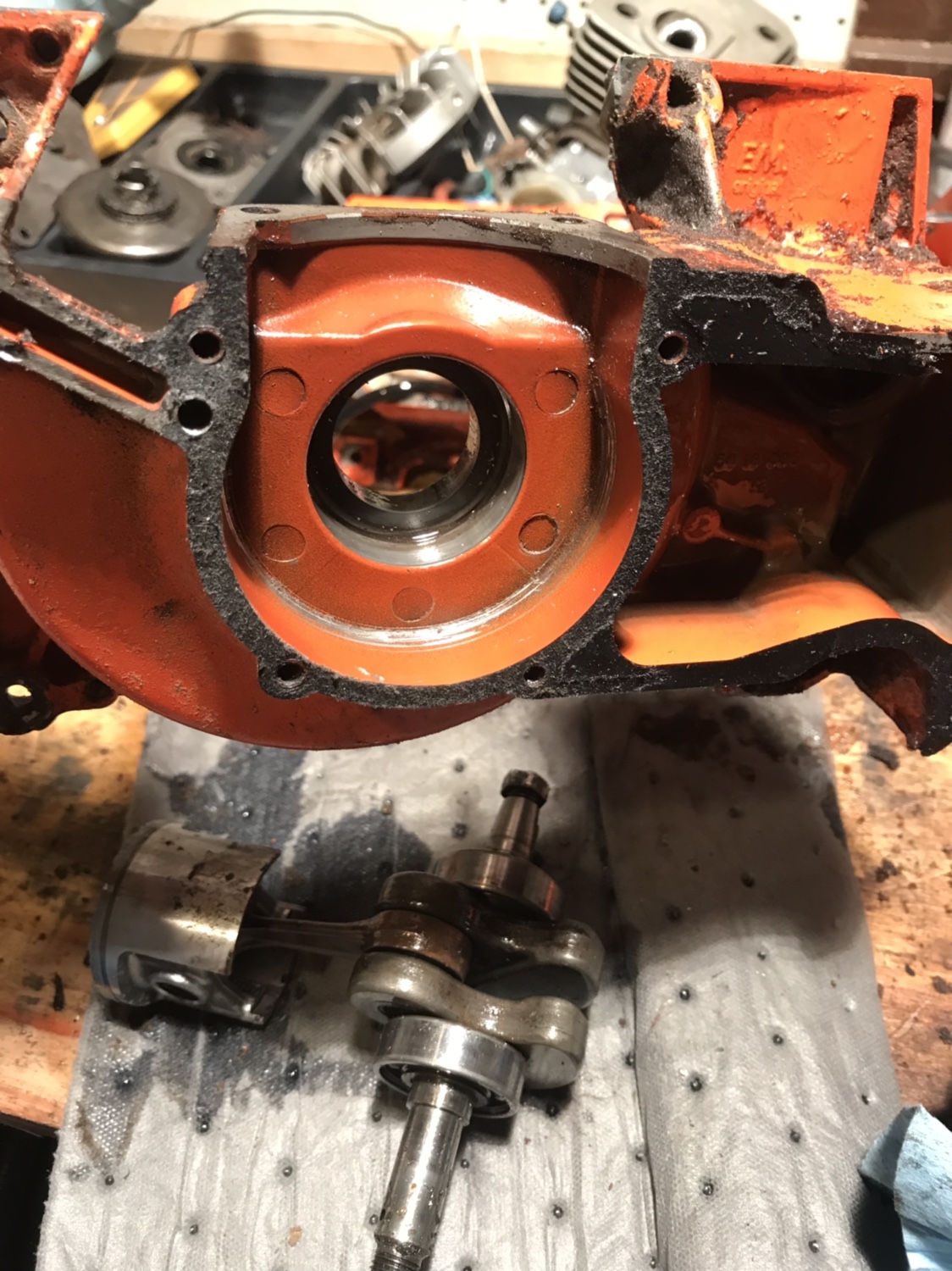

Yep. I’m currently splitting the case. Any suggestions

No I don’t have the tool. I have a heat gun and a rubber mallet. I don’t plan on doing many case splitting that I could justify owning the tool.

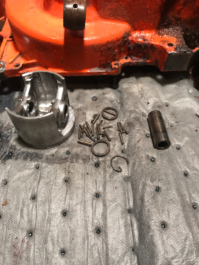

Still haven’t found the offending hunk of whatever. Or where it came from. Yes screws are in the butterfly’s of the carb.
..... hold that thought
That doesn’t look good.

Just a heads up, the last saw I did that had that much wear on the inside of the crankcase wouldn't hold the bearing. From the looks of it, your crank bearing was also down and let the crankshaft wear into the case. Don't be surprised when you get it back together and see the outer bearing race turning inside the case when you spin the crank.

My guess too Dustin. The bearins actually feel smooth. And I had to beat the heck with heat and hammer to get them out of the case halves. But I’ll make sure they don’t slip.

Not very often the wrist pin is the offending bearing. That's very interesting
Case splitter is usually under $60. As quick and easy as it splits em and leaves the bearings in the pocket where they are much easier to remove, hard not to justify the small investment. The basic splitter that looks kinda like a C-clamp works on every saw I've torn down that did not have stuffers. If I recall I paid $60 (before Husky lowered their prices on special tools) for it from my local dealer. I've done 242, 262, 288, 359 and a 394 with it.

Ummm if that bearing went down, what are the chances that it didn't damage the connecting rod? Not trying to be a negative nancy here, just thinking things through!
It's pretty easy to inspect the rod and big end bearing. If it feels ok and the cage is undamaged there's no reason not to use it.

Oh I agree, just posting thoughts on what needs to be checked closely for him before putting it back together and having a problem show up.
