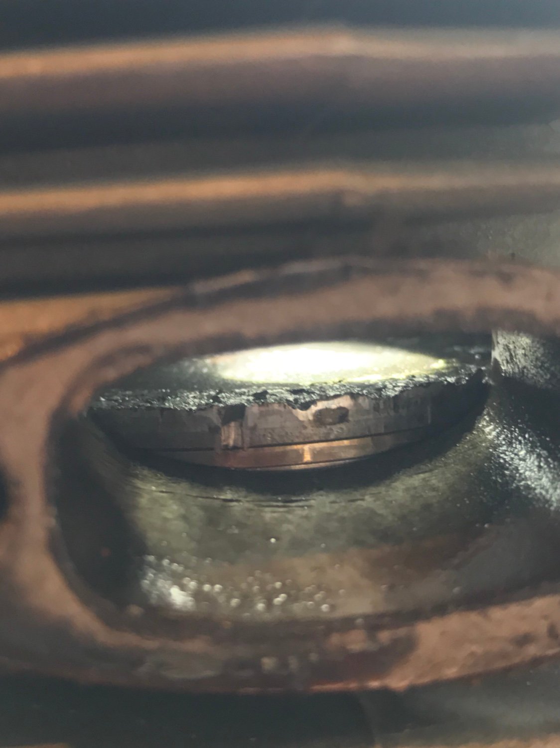

Well. I should pulled the muffler first thing. But I just got the “temporary “ death sentence.
This will shelf her for a significant period of time. Being that funds and time is short.
Btw only 70psi compression. Hopefully it’s just a piston and not bearings too.

Can’t like that, looks like something was bouncing around on top of the piston. The good news is when you’re ready OEM top ends can be had for $150 or less if you end up needing a cylinder too.

Hate to see that. It certainly doesn't look to good.

If the bottom end is even a little questionable or you aren't sure if or when the crank bearings and seals have been replaced, I would go ahead and swap them out. $50 is pretty cheap insurance to make sure your rebuild lasts

And check that lower rod bearing cage real close for signs of the retainer failing. Had that very thing wipe out a 288 cylinder I was in the process of porting. Brand new SKF bearings and seals and it blew my mind when I pulled the cylinder to make some more changes and found a scratched up piston and plating damage that turned the cylinder into a paperweight

You and me both. In my estimation, the lower rod bearing takes the most abuse of any bearing in the whole engine. You can have pressed together cranks from bikes, sleds, wheelers and whatnot rebuilt but not these as far as I'm aware. Seems as though it would be cost effective to have it done if you could source the new bearing and crank pin, a new 288/394 crank is crazy expensive last I looked
