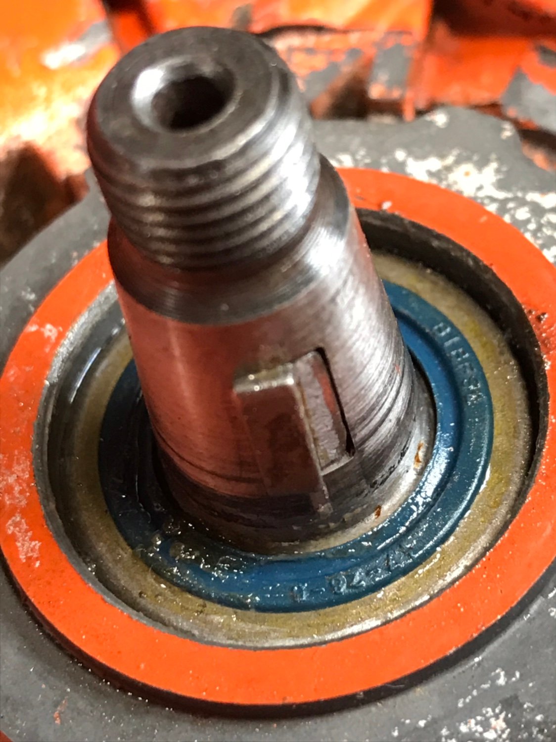

Do you guys think this is a sheered key or timing advanced? I’m putting a new flywheel in do to a screw coming loose and knocking all the fins off. The piece that is sticking out isn’t loose even when I tried pulling it off with a pick. I always the the timing advanced keys were just filed down on the one side?

Looks sheared too me. Probably happened when the screw was busting fins off.

It’s the wrong direction to be timing advance, and it looks sheered too, plus it looks too wide to be a standard key filled down, they do make offset keys for atv an motorcycles but I haven’t seen one for a saw

Key starting to shear.
