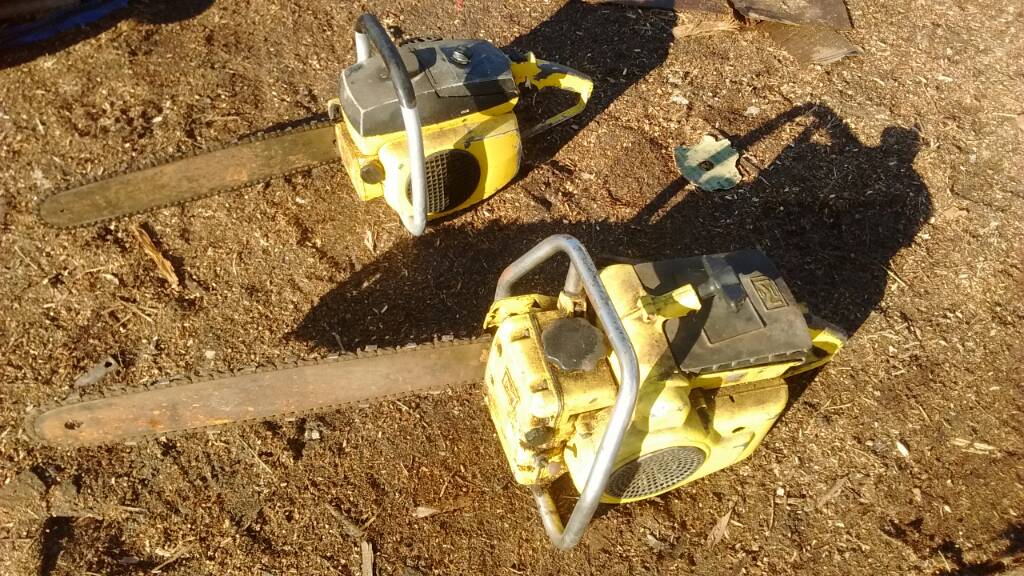

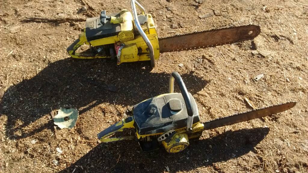

Hey I only sell and fix these modern saws to feed my yellow addiction!
Good cause I got you a couple more to mess with!

That D36 is really looking good Chad! Is the other one 2-10?
I put a few more tanks of gas through this 562 today. It's still putting a smile on my face when I run it!
I tried to id it via serial # off acres and best I could tell it would be an early super 10-10 right hand. But your the guru you would just have to check it out. That D-36 has a piece of aluminum or something screwed into the back of the chain cover.

Will the 1-43/250 covers fit those cause I have a few....

The 1-43 cover will fit, but not 250. The black cover and full wrap handle are what id the d-36 for me. The other one does look like a 10-10.
