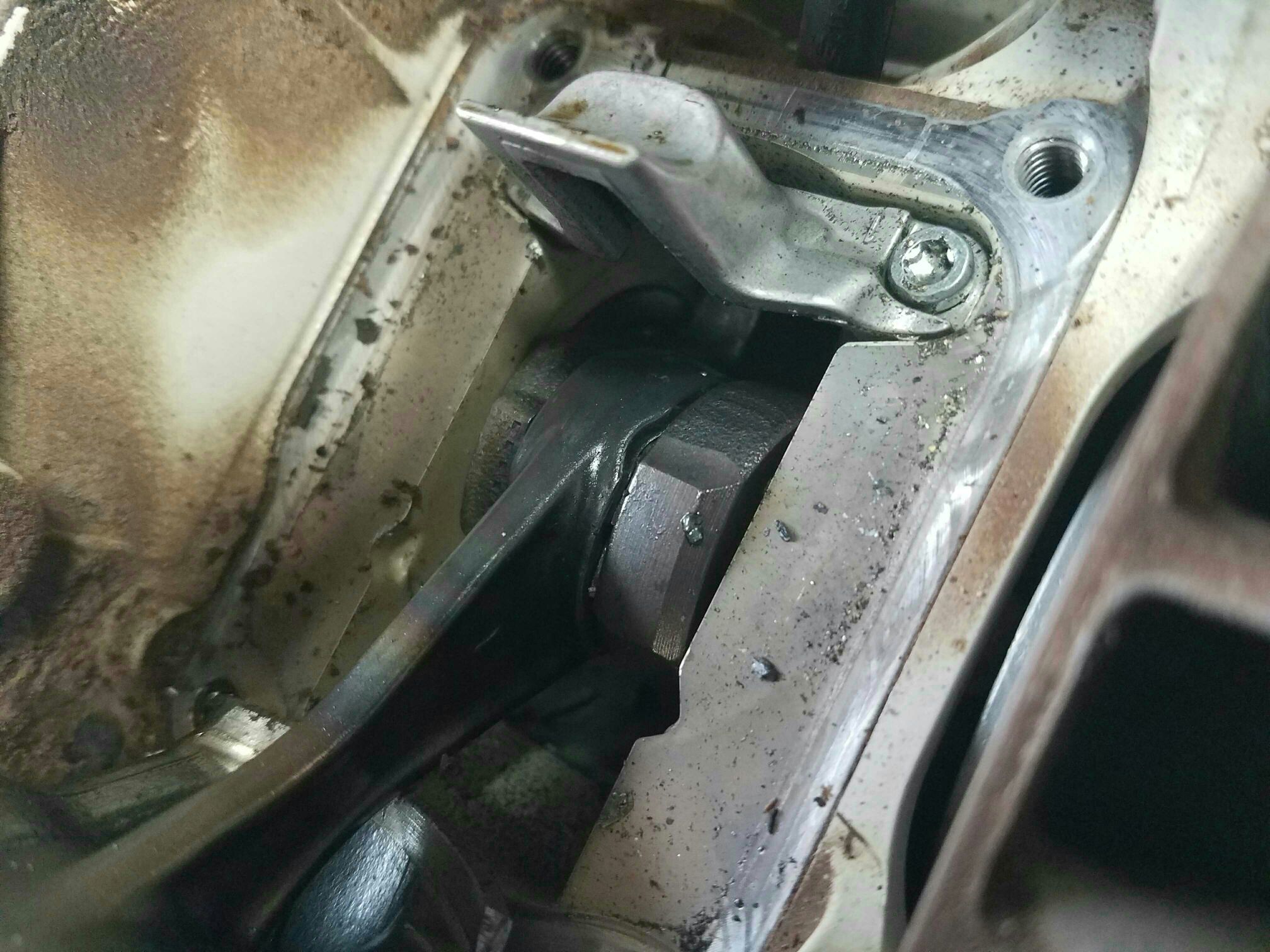

Can any one tell me if a regular old 660 crankshaft will interchange with a 661-c i have one I tore apart. PC looks great it after getting the jug off i found the lower rod bearing is burnt blue and cumming apart. I was also wondering if any one has adapted a carb to this model saw yet thank you.

A friend and I were chatting about this very crank swap in reverse order and I believe he said the 661 crank was wider...or vice versa I'll have to check.

No, they don`t interchange, the part numbers and stroke are different.

Wow, not sure how I forgot to mention the 661 stroke is 38mm and 660 is 40mm. My buddy and I were talking about some custom stuff.

I'd love to know why they shortened the stroke!
