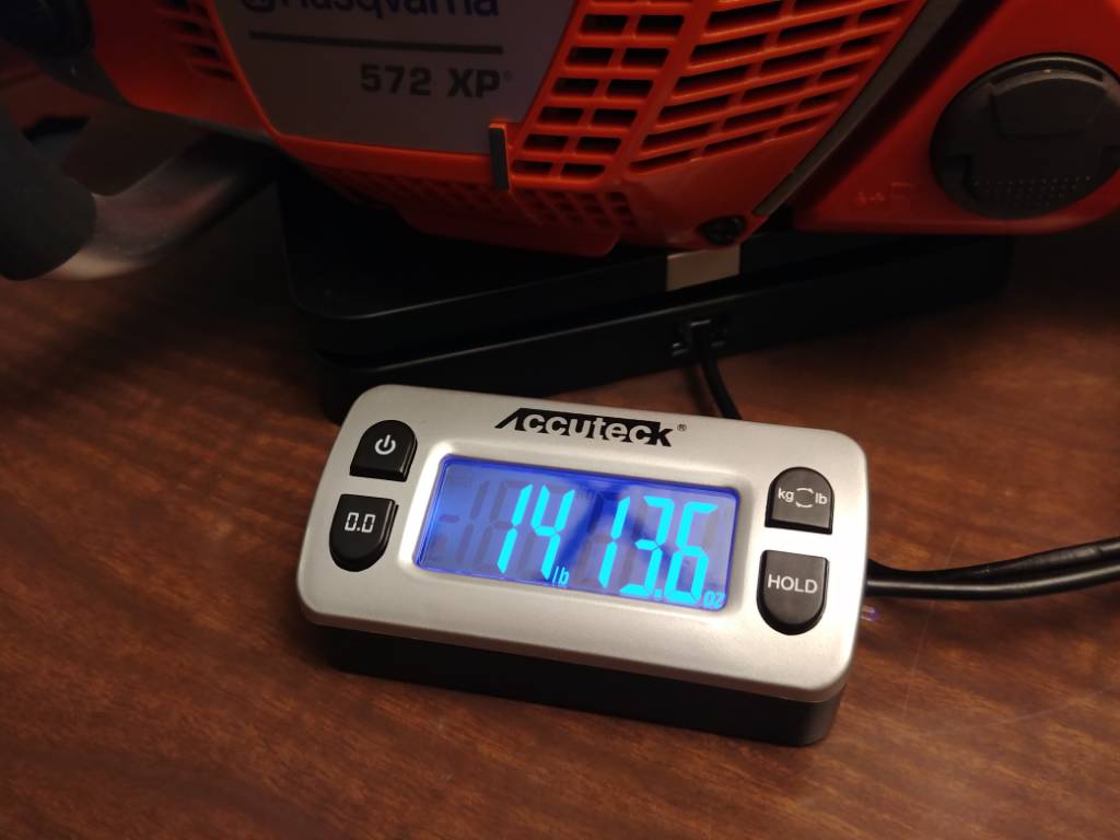

I would swear Andre posted this here in the thread. PHO dry.
Also I know the guy that showed the 372 572 with 20" and fluids. Good honest guy. Also I think both of the saws have been ported by Jason Egan from ID. So they may weigh alittle less. ;) :p

Mind if I put this image in the gallery, Andre?
BTW, the 572 has loads of stroke. I am curious to see if they are gonna simply release a slightly modded BB version for their 80cc saw.
