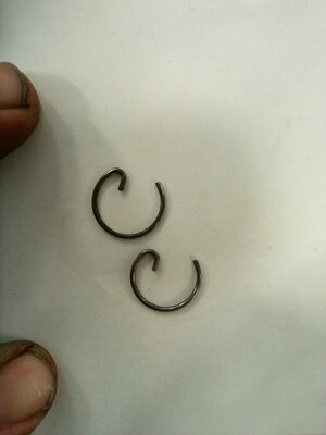

Pardon my greasy fingers, but has anyone else had trouble with the circlips with OEM 395 pistons? I received a new piston today and found that the clip was next thing to loose after being installed into the piston, easily spun with a fingernail. I ended up using the clips from the old piston, which fit properly and are obviously larger.
old clip upper, new clip lower
