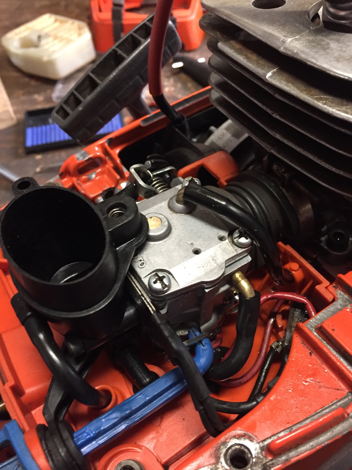

i did a swap back to back on my walkerized saws and a stock saw. it did change the way they run. maybe not to a significant advantage but it did. i have a 385 ported from down south and it did make a noticable difference on it so i left it on that one. would i go buy a larger carb just to put one on? heck no! would i do it if i had the carb, heck yes. the 296 is the most reliable carb IMO. after a year of solid work you can pull apart a 296 and it's still in good shape. the walbro's wear weird on the metering diaphragm nipple/lever and need a rebuild after so many hours. the tilly's last the life of the saw if not left to sit. i've bored the 296 out to as far as 20mm even. takes some work with JB plugging the fixed jet passage and drilling the nozzle same size to compensate. i would never bore one out past 18.25 max if i ever did it again. i found the WJ39 stock to run the best but i didn't time any cuts. i also didn't leave it on there because the throttle and choke shafts are wackey for the 385/390. gonna try the 118 shafts in the 39 next time i get a 118 in here.
Here's one rigged with a 39. Definitely the most difficult of all the swaps. Might be easy with the 118 shafts?
Good info sir. :)
