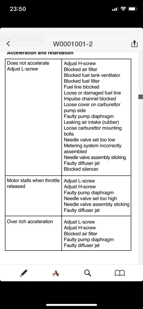

Looks like you’ve ticked off most. Maybe the tank vent?
