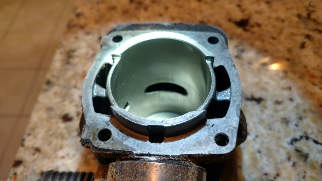

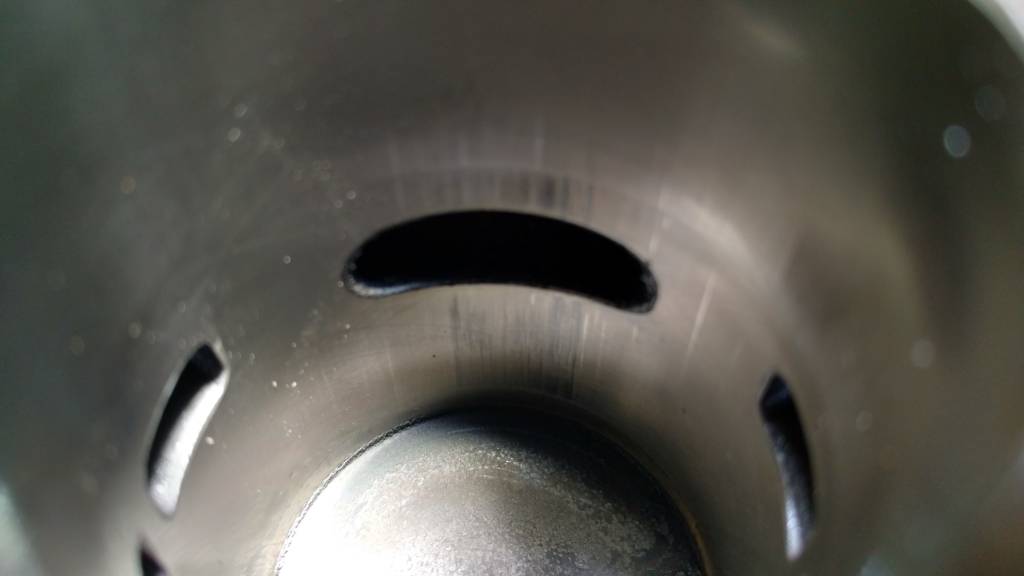

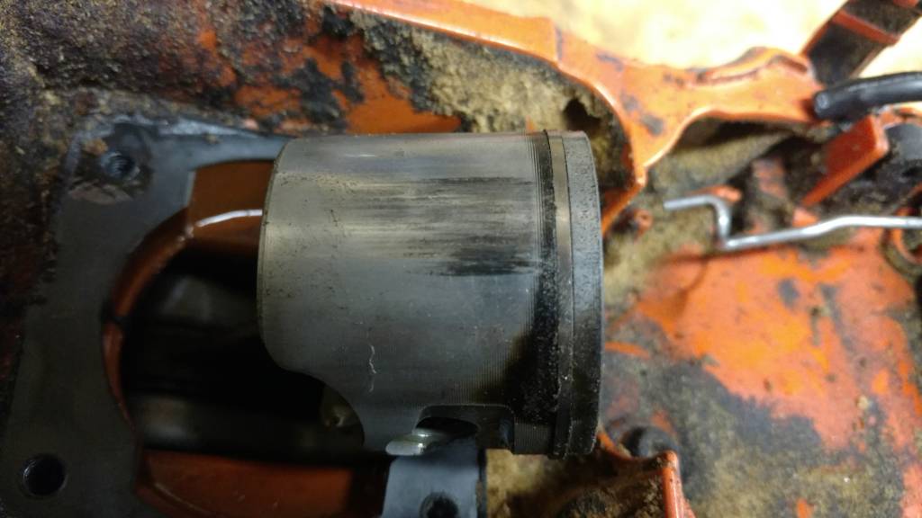

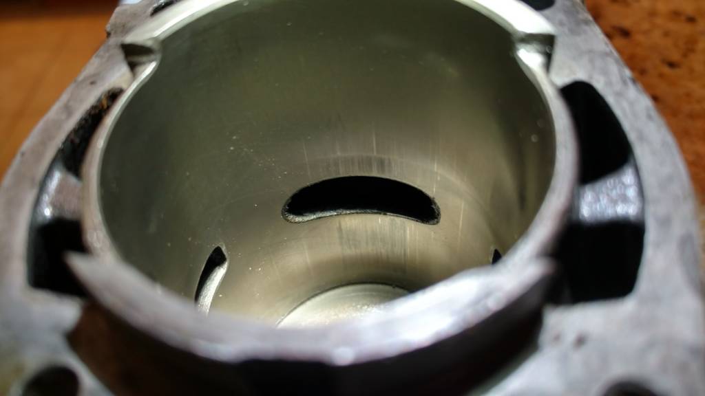

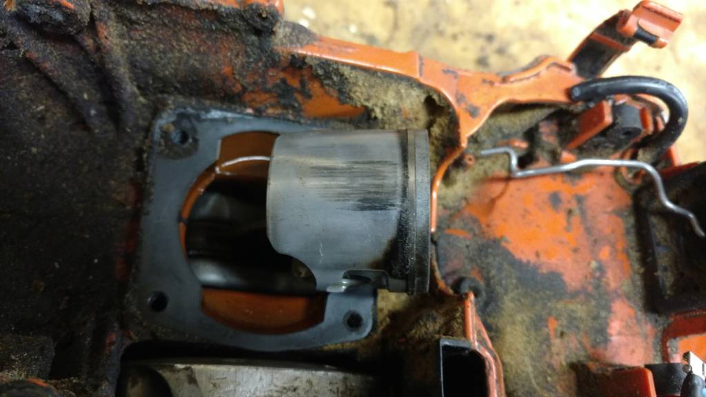

Did the rebuild of this saw tonight. New OEM 50 CC piston / cylinder, new fuel line, new fuel filter, new intake boot / clamp, new carb (zama knockoff recommended in this thread), New impulse line, New muffler.
Here are some progress pics I took. No base gasket to get compression increase.
Hope shes does well for while now.
The new carb has the extra inlet for primer bulb, but this saw has no primer bulb. I'm assuming I can just plug that inlet? Suggestions how? For testing I plan to put some extra clear fuel line that came w/ the carb (for the bulb that came w/ carb) and pinch the line off with hemostats. If I can just plug it, I'll need a way to do that permanently.IMG_20180304_182726391.jpg IMG_20180304_185852575.jpg IMG_20180304_185902761.jpg IMG_20180304_190703911.jpg IMG_20180304_190717223.jpg
