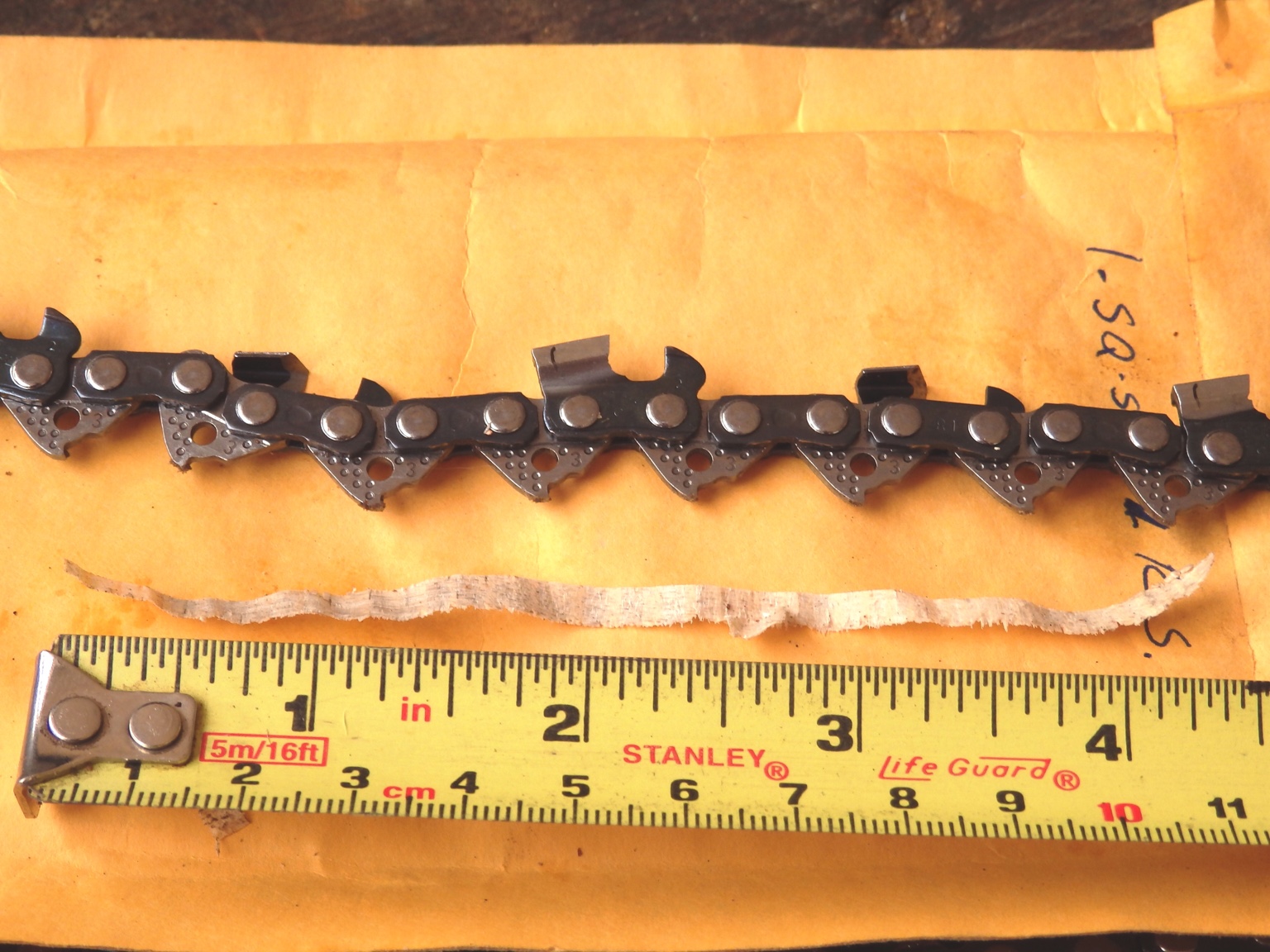

So I decided to crank up the ol' file and give my sons .325 a go. Gotta say I'm not a fan :roto2nuse: Not much room in there to get goin'. I was on tie strap for a while till I got the clearance to finally get to the sweet spot. Go ahead and let me have it...

Won't be able to test it ot for a while due to sub arctic weather.

Try to keep the file on a steady plane as you move it into the cutter, especially on the last couple strokes. This will help to make a cleaner and smaller working corner, along with a more pronounced intersecting line under the cutter and through the point.
Also, try to blow the filing crud off the cutter a bit so the camera don't make optical illusions and misleading shadows.
Good pics of cutters can be a challenge.

My last pic, I'm hesitant to remove anymore tie strap. Do you get similar results?

I think you're fine on the tie strap. I haven't played with working angles so I can't help you there. With what I'm doing I'm not hitting the straps.

Try taking a round file and cleaning the gullets out real well before laying a double bevel file in there. It will help you keep from snagging the straps, which tend to throw off your angles a little..
On a race chain, I don't get the straps, but I do on a work chain.

Angles held up just fine to my surprise. Was throw'n some bigchips near 5 inches long "crosscut"
