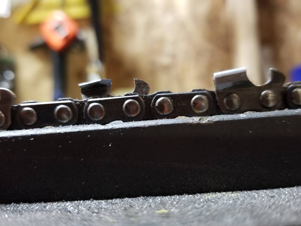

Out this am sharpening chains. This is a
.325 semi chissle. Sharpened free hand 3/16 file. Dont normally run semi but this chain was free so not complaining. Lol.
Semi cuts a lot better with a deeper gullet. Do a test to understand what I mean. First try some cuts with it the way you have it. Then break out the files. Push down and back with the file to cut the gullet deeper. Maybe two or three swipes. Leave the top plate alone. I find if you file properly the gullet only needs filed once in a while. Try some cuts. You’ll notice the chain self feeds much better. You can play around with the raker height. I also find chains with those dual hump safety rakers you have to take moreoff the raker than a normal chain to compensate. That said... be careful with taking too much off with semi... the line between too aggressive and just right is a lot thinner than normal chisel chain because semi doesn’t cut as smooth to begin with.

Not the greatest pictures but hopefully you guys can see what I’m talking about, look at the gullet and amount of hook. This is stihl rm semi chisel. 69789D01-EC38-4BA5-8204-E179FB256773.jpeg9540E132-2320-4919-A53B-B254E29A7242.jpeg
I took four passes off the rakers after the pic. It seems to self feed pretty good.
I would have to drop down a file size to go back in the gullet a little further. File fills the whole space. I went down till i was just marking the strap. Dont want this chain too agressive. My 14 year old son runs this saw most the time.
