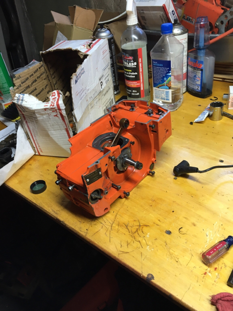

Ok finally got the saw cleaned up.
time to start putting her back together. I thought I was going to have to split the case because the bearings felt gritty. Cleaned it out with gas and then diesel, lots of black crap, put some 2 stroke oil on them and voila, smooth as silk!!
