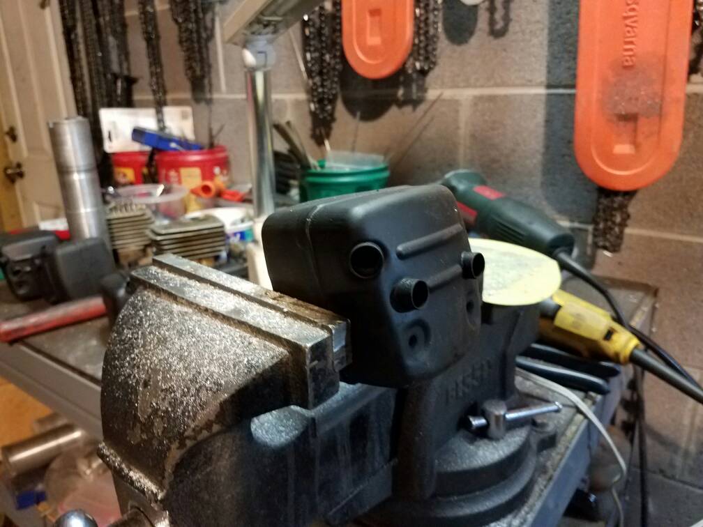

What I started with on the muffler. These sound good and kill some of that high pitch that the 365/372 usually has. I'll get pictures of the after when I get back home.
Is that a Hutzl Muffler, are they more free flowing that oem Husky top deflect?
Farmertech I believe. I have some here if you would like one. It's close to the same area. I'd have to do some ciphering to know for sure

Use a cutoff wheel to make a slice 1/2 way through the pipe outlet and insert a screen. Use a screw to hold the screen in. I'll try to find a pic of one I did. I sold the saw and it needed an arrestor.
