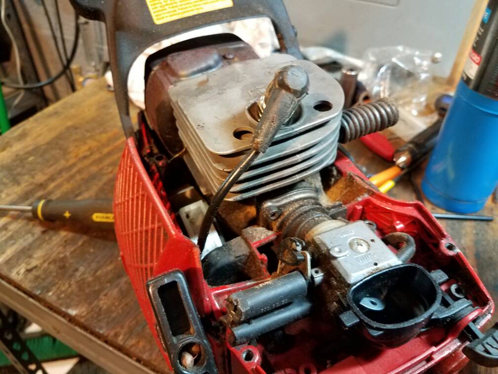

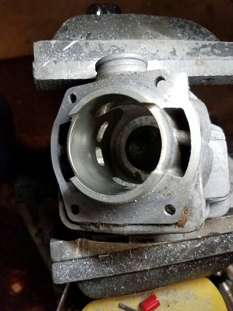

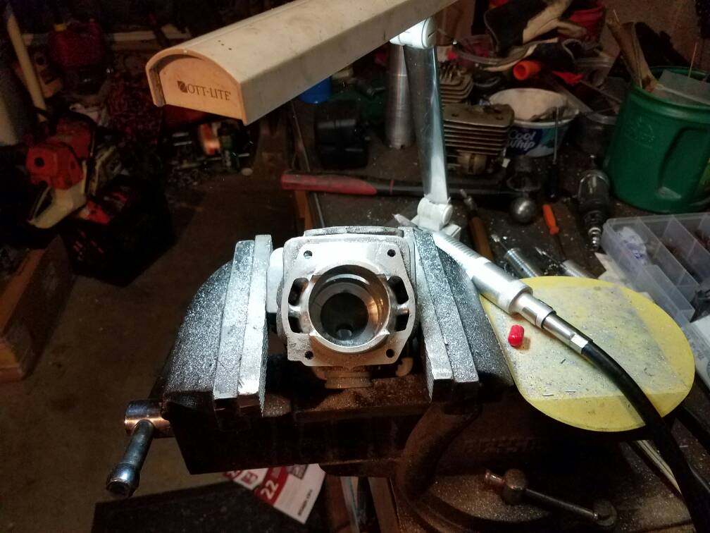

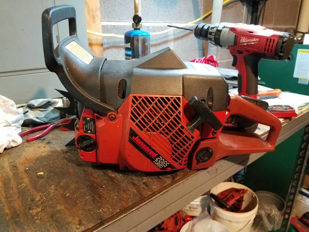

I decided to build one of my favorites. 365 special top end on a jonsered bottom end.
Hmm. Bolt on intake. Open port cylinder.

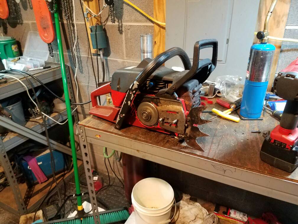

What I started with on the muffler. These sound good and kill some of that high pitch that the 365/372 usually has. I'll get pictures of the after when I get back home.

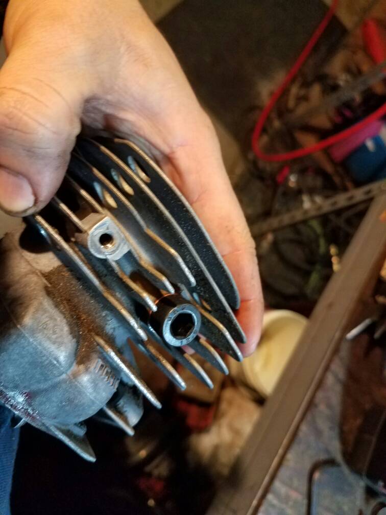

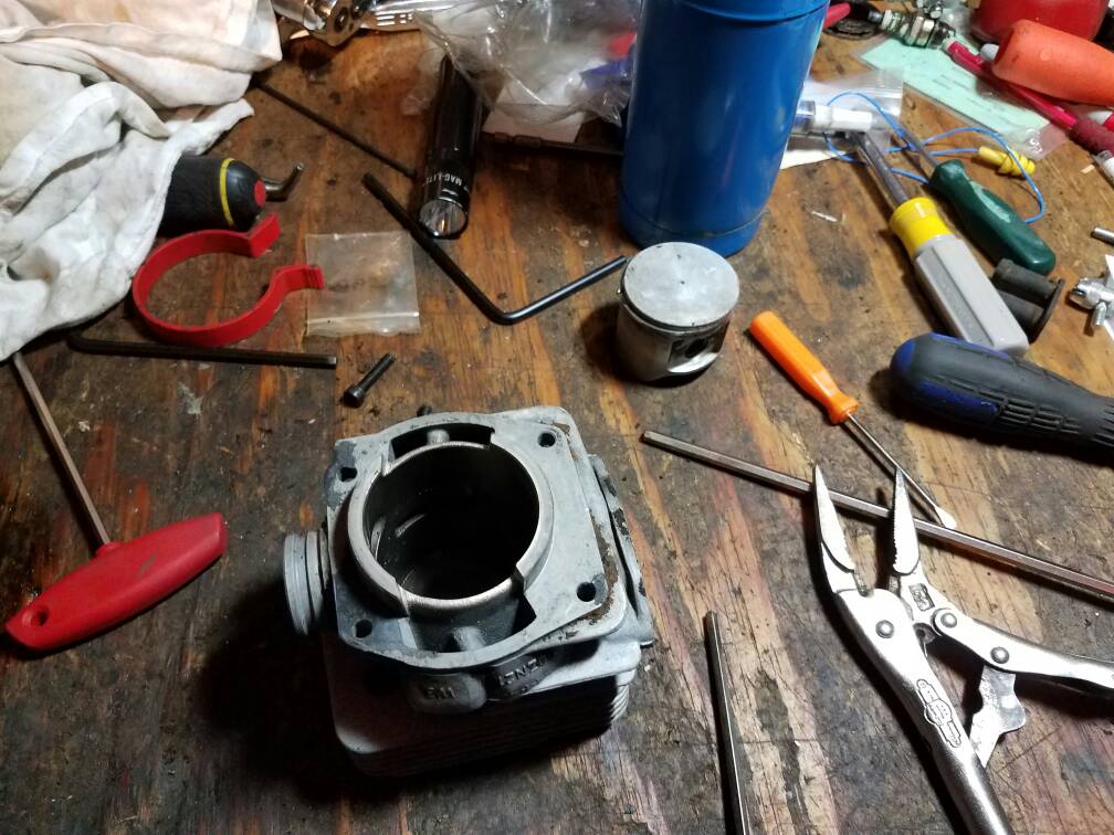

All that work to find out the decomp hole is stripped. Be looking for a tap and a plug.

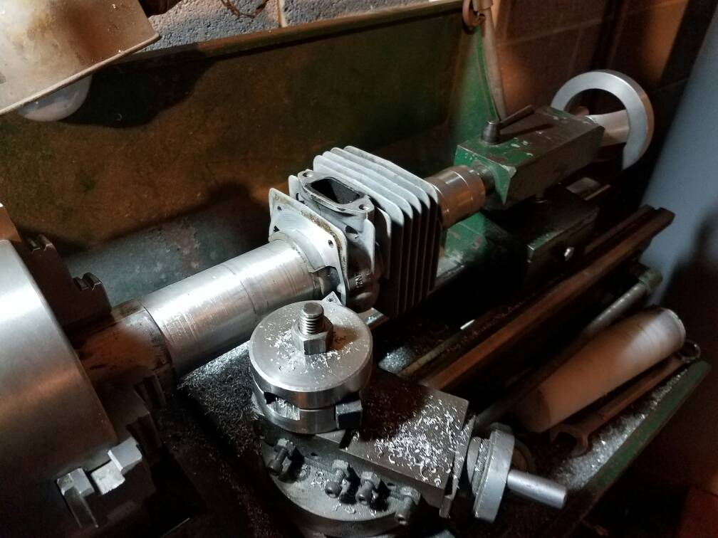

Are you going to post up what you did with machine work, porting, and how you chose what you did?
Yep. I'll put the numbers in here now.
Exhaust 103
Transfer 122
Intake 76
Cut .054" off the base and no gasket. I didn't measure how much I cut from the chamber. I just check it until squish is what I want.

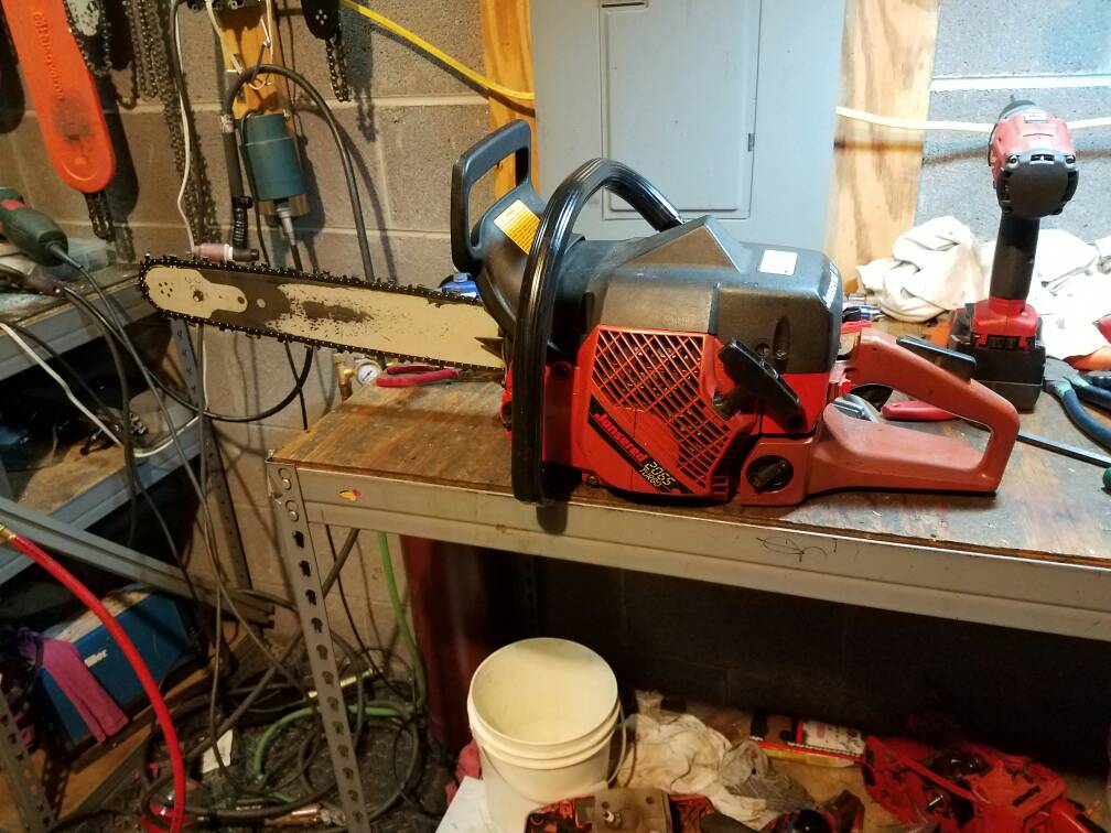

24" a lot of the time. I put a 20" on it for now.
2065 has both open and closed port. The 365 special is closed port.
