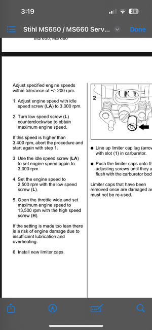

I have a 064 with a thin base KS 066 piston and cylinder and I need some advice on tuning. I am very hard of hearing because of injuries I received in the Marine Corps so I have to use a tach for tuning which usually isn’t a problem but the 064 manual doesn’t have a procedure for tuning with a tach but a ms660 manual does and when I try to follow it I’m running into problems and I don’t know if it’s because the 660 procedure won’t work on the 064 or there is something else wrong. I have tried it with both a Bing and a Wj-34 and got the same result when I try to follow the procedure in the picture below I can’t get the highest idle below 3500 even with the LA screw backed off all the way. I have done a pressure and vacuum test and it held both perfectly. So I’m lost any advice would be great appreciated IMG_2386.png
