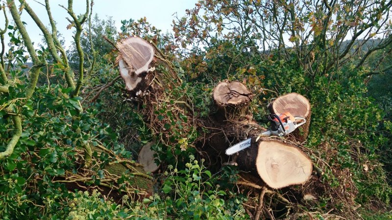

Bucked all this Oak + Hickory with less than one tank of fuel with the 044 and a 28" light bar. It pulls it well, but I like it better with a 20" bar. I put the 28"s on the 77 cc saws.
