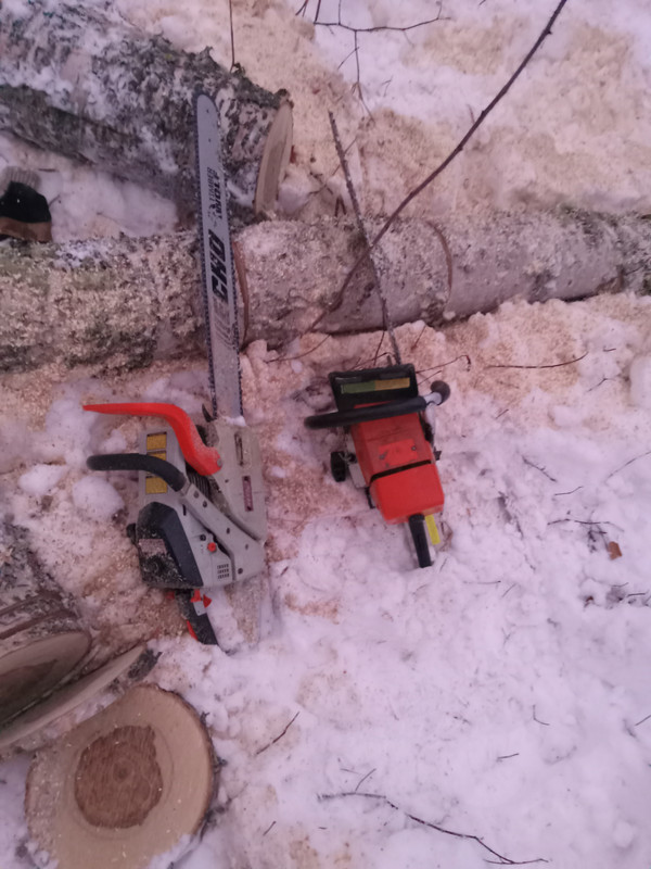

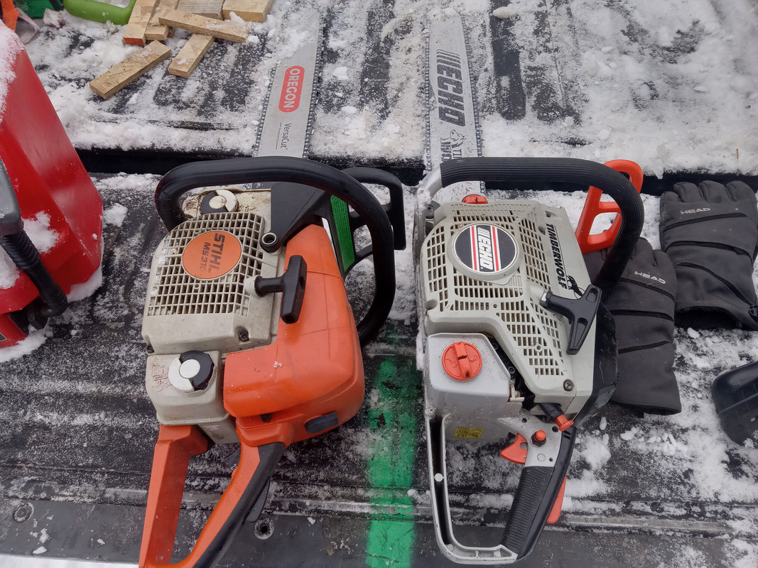

I've since used Right-Stuff on 3 chainsaw builds. I ported an echo cs-530, a stihl ms 310, and an echo cs 6700. All three are running great.
On the echo cs 530, I tore a felt walbro carb gasket, I even repaired that with right stuff. It has no carb issues.
