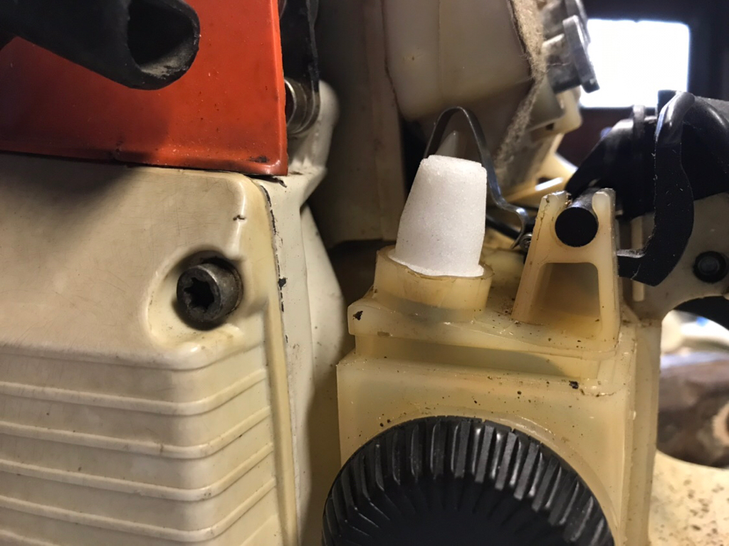

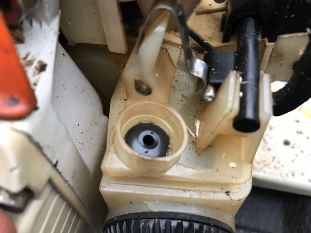

Ran across this thread recently, I have read it over and over. Now I have a question for my 026 non pro. The vent was missing when I acquired the saw . I’m thinking this is not the original tank because of my serial number is so early, x19 187 650. I think the saw came with the tall black vent, but that certainly won’t work here. Check out the fuel cap, the ridges around the edge are very fine. Is that an older cap on a newer tank? So far I have replaced the duckbill but I see that the area is going to fill up with sawdust quickly. I’m looking for a source for the missing parts. Someone that will get it right the first time. My local dealer is no help whatsoever.
Here are a few pics

If you see those ridges on the recoil cover near the fuel cap, that is another clue that it is an early saw. Lots of these have been reconfigured over time. Lots of versions, maybe more than any other saw out there?

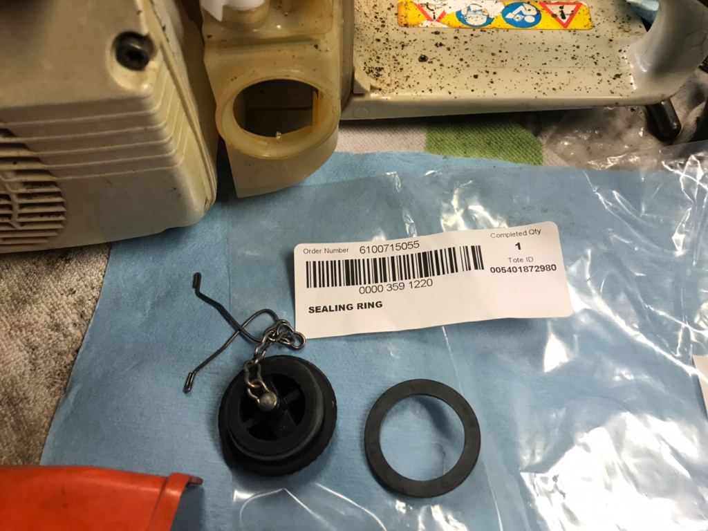

I think you nailed it Glenn. Looks like you could use a new rubber gasket on the fuel cap too. I hate a fuel leak...

Your 026 may not be all original, but that doesn't matter. The starter cover and gas caps are older. The fuel tank is newer. It is translucent. The fuel tank that matches the fuel cap was solid white.
As long as saw runs good is all that counts. [emoji106]

Look at post number 140: Red lever early, tower vent early, transparent tank late, smooth recoil late, deep ridge fuel cap late.
It is just endless with these things. They all tend to rip (for their weight) with an open exhaust and two screw carburetor.

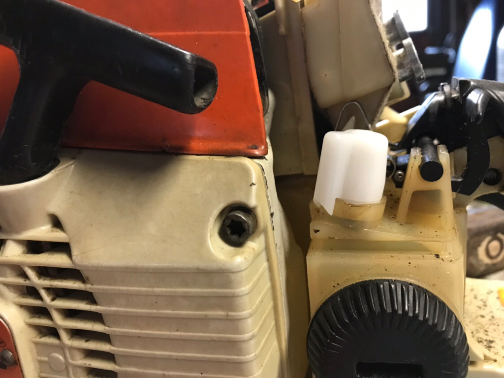

Vent parts came in today. Everything fits great, here is my take on the vent thing...
These parts fit a tank that it transparent, has screw in fuel cap, not a flip, has the old style fuel line, and a black rubber duck check valve. I would go as far to say that if you know you have any 3 of the above, you probably have all of the above on your saw.
