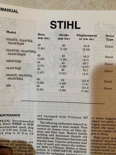

This page in my Clymer chainsaw overhaul manual has me confused.
Lists two different crankshaft stroke for the 024.
I cannot reconcile the same piston being used for a 30mm stroke and a 32mm stroke and have the same wrist pin to crown height. [emoji848]

The 024 supers had a crank with longer stroke, kind of a stepping stone to the 026. Not sure how they made up the difference, i would guess that an 024 super cylinder next to an 024 cylinder would show the 024s being a little bit taller, but i bet @drf256 would be able to pinpoint how they made up the difference
