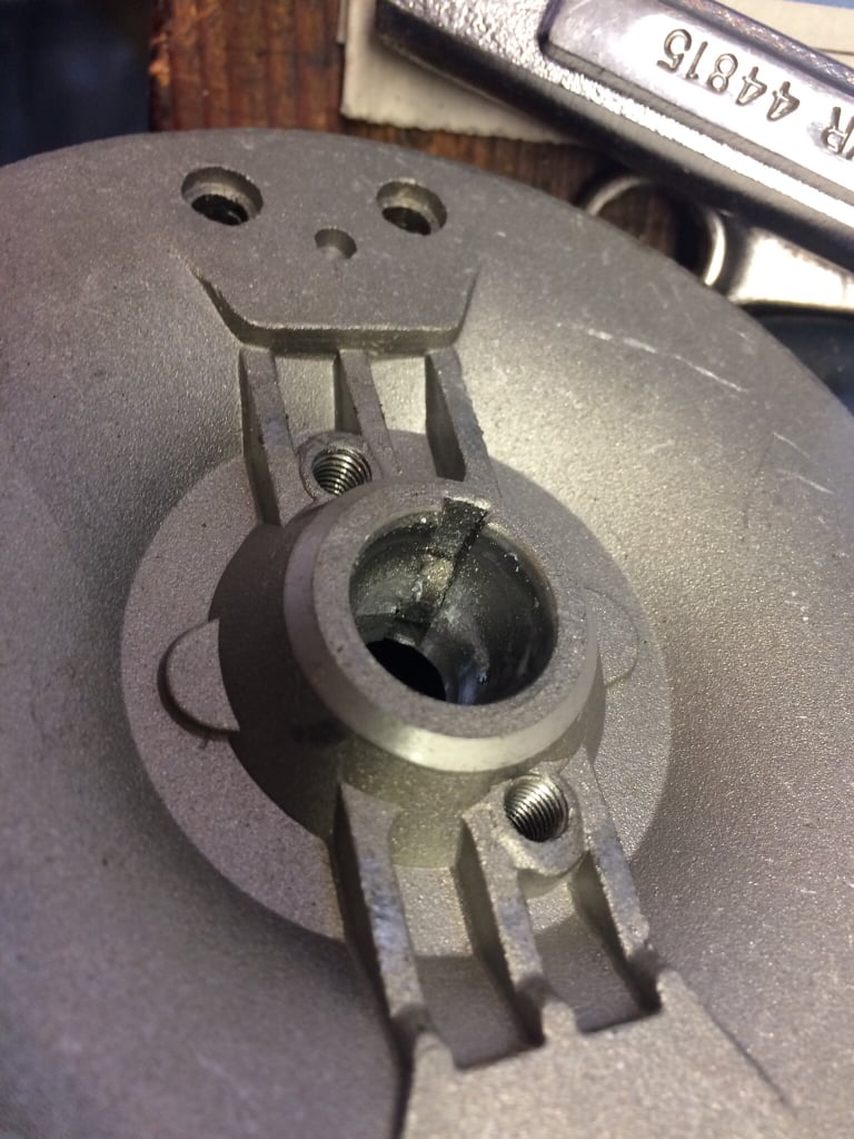

Actually, the key helps the flywheel stay in position for pull starting more than anything else.
Above damage caused by loose nut when pulling it over.

My solo had some casting marks that wouldn't let the flywheel seat all the way

As has been said many times, the taper holds the crank. The key is just to help alignment. If your destroying cranks, look for the reason the taper isn't right.

Or not clean. Friction in that taper holds it, any oil/grease and you are toast! Scotch Brite or Brake Cleaner will generally work.
