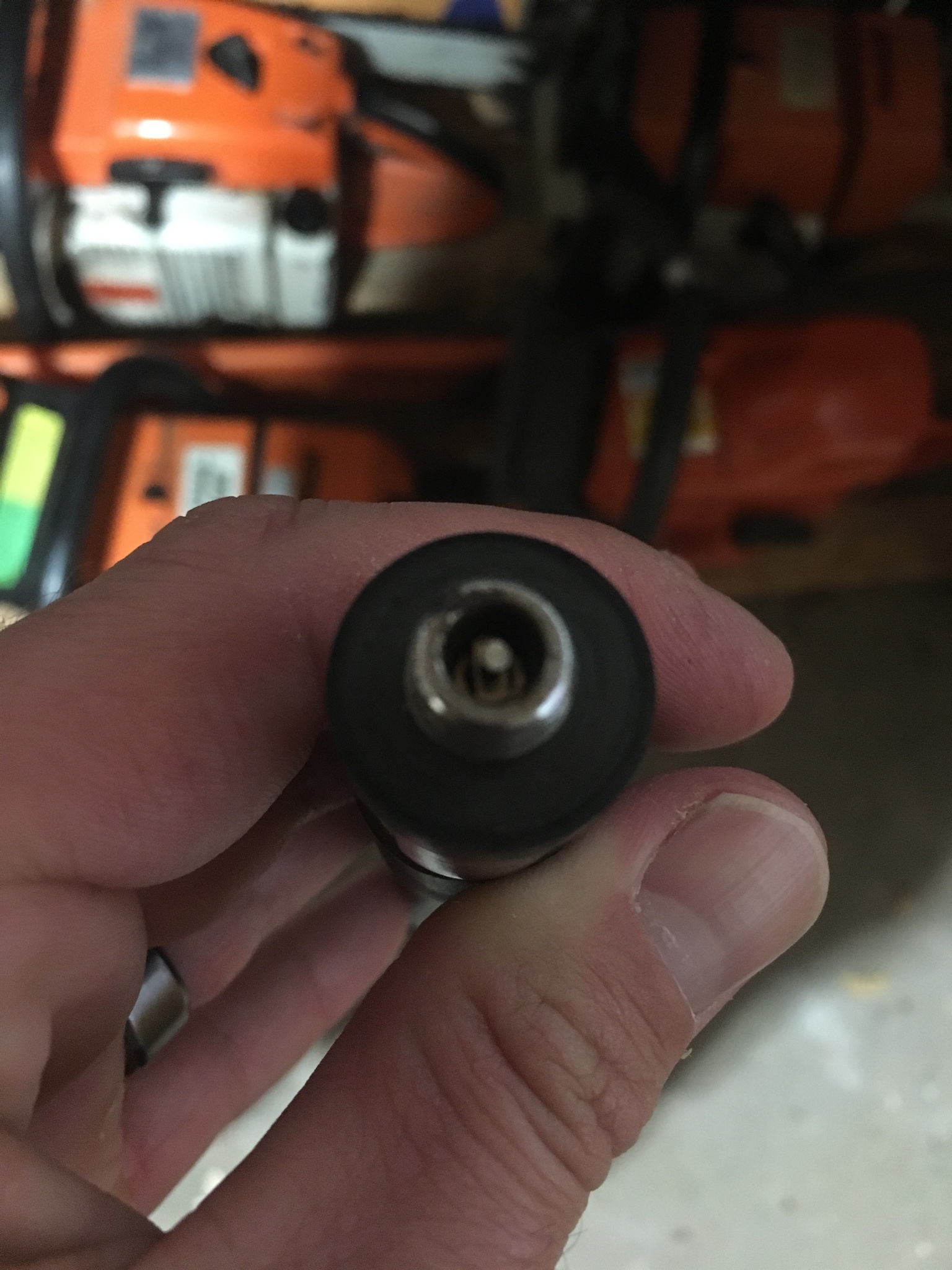

White Schraders in all my old ones , the new problem adapter hose had a black valve, it was sitting pretty deep in there alsoIMG_2297.JPG I switched it and guess what?

You might have saved me a lot of money ,time and trouble friend. This got by me because it was a brand new Snap On part. Boys I think its solved!
