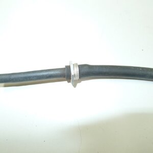

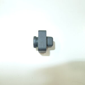

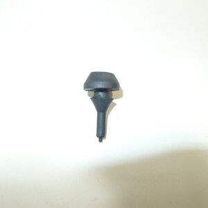

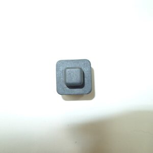

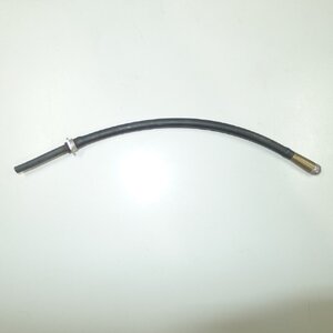

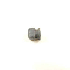

I found these two things in a Husky parts lot that I can't identify and looking for some help.
The first appears to be an oil hose and I would have guessed that it was from a 2100 but it seems too long. It is 11.25" end-to-end and about 2" above the nut.
The second is a rubber buffer that appears should be pressed into a crankcase based on the round end. It is about 0.75" end-to-end and the larger square part is also about 0.75".

2nd piece goes where the little "ear" on a 2100 clutch cover meets the case. I can't remember whether it goes in the case or the clutch cover, but I'm confident it's that piece.

Good possibility the oil line is from a 2100 (or close sibling). The pickup looks to be close to 501544102.
That's what I thought too but the internal length is much longer than anything I've seen before on those models.

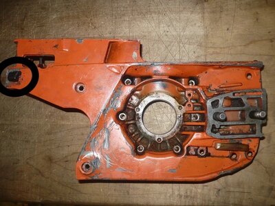

I dug up a pic, I think it's the little circled bit on this case.
I thought that too but the part is about twice as tall off the crankcase surface as the one for the 480/2100 (last two pics). They do both mount in a 10mm hole though. I'm trying to nail down the part number for this.
