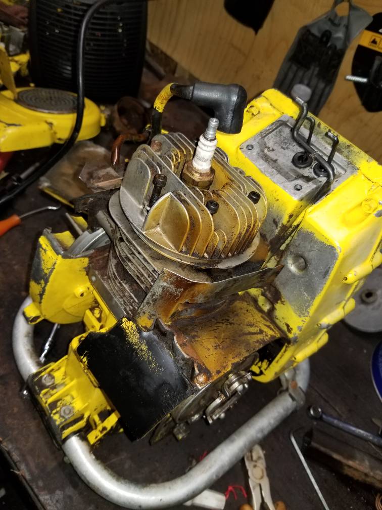

Well i got the rings out. Not how i wanted but ther out in many peices. I tried soaking in the ATF for a night. Then mixed 50 to 50 with atf and acetone. Nothing. Tried heat then spray with wd 40 to try and shock it a few times. Never worked. Tried some special penetrating oil my BIL HAD. It freed up the lower ring with lots of messing with it. The top ring was just like crazy glued in ther.
Ther is also a little grove all the way around the pisting that is plugged full of this stuff.
I orderered a set of new rings off ebay so they wont be here for at least a month or so. I hate ebay for that reason but oh well. I will have to box it up for now to get it off the work bench.

Well rings came in. Makin some progress getting it back togeather. One head bolt was stripped so had to drill and tap a little bigger. Now im at the handle.and trigger stuff. It kinda just fell apart while taking stuff off so it may be a bit of trial and error getting it togeather. Gonna wait a day or so. Got a few other things i gotta get done.
My son was cleaning parts befor input back togeather.
Oh and it does have spark. Was kinda worried id get togeather and it wouldnt.

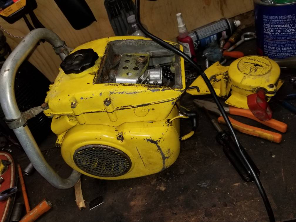

Got the the handle assembly toheather and the recoil back on then dribbled a little fuel down the throat of the carb. Gave it a pull and my gosh she popped. Pretty eciting when ya hear em pop for the first time. Makes ya wonder when the last time it ran was.
So now im gonna move to the fuel tank. It has some white stuff innit full of saw dust. Thought i read somewhere the white stuff is a filter material? If so kine junk.
Think i will end up having to split the tank to clean up. Then will have to find a new gas cap or epoxy this broken one till i find one.

My super 44a has like a felt filter liner of some kind .I've got the bones of a super 44 in the shed that the tank top is bent .Let me take a peek tomorrow .

The fuel cap has a hole. My first thought was a mouse made a nest? The stuff kinda looks like cotton ball material type stuff that i pulled out.

It most likely had a screen type vent at one time .It's like some type brass stuff .I may be wrong but I think any of the large screw caps will work .I'll check that too .
