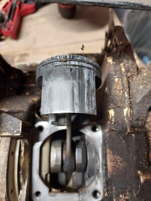

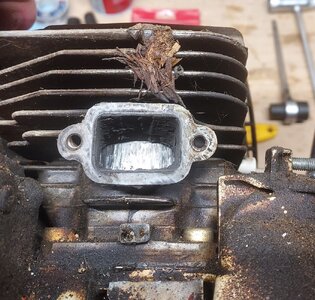

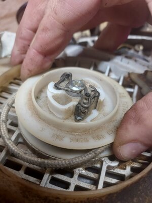

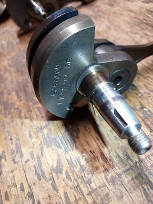

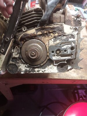

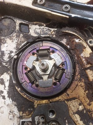

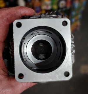

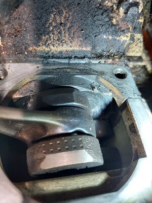

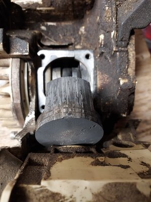

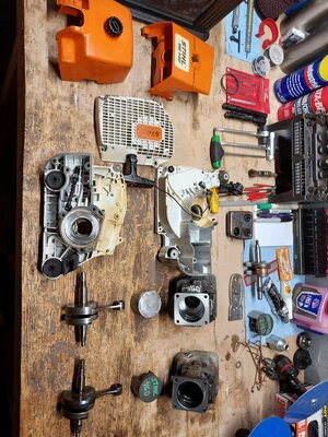

I built a 461 for a logger... and that led to doing his 462 and then a 460.... I can say with 100% absolute that This was the worst Stihl 460 I had ever worked on... he said it ran up until it didn't. Well Yep.
Said it has compression... well, it has resistance... coil was fried, piston and cylinder was toast, crank was purple, clutch was purple, bearings and seals were shot, carb was clogged, start pawls, recoil, drum and bearing shot, case was junk... I told him that he'd be into it over $800 in parts etc. He said, "nah, keep it for parts"... 😒🧐... well, I had 2 other junk 460s.. so, I grabbed every part that looked like it had some life to it... and started game planning.

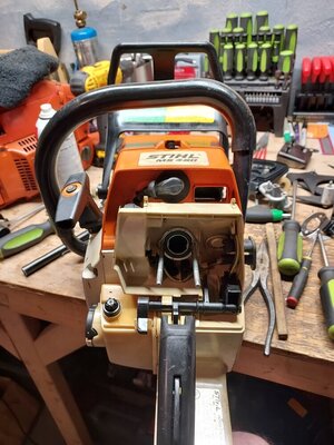

It supposedly ran until the coil burnt up??? Ummmm, if so, that would be a testament... I think.

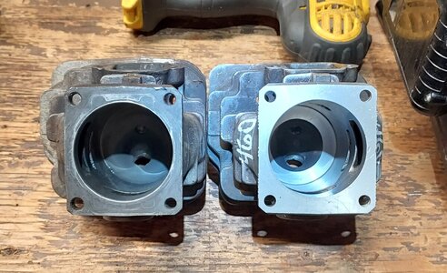

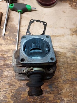

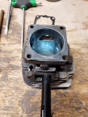

I had decent OEM cylinders that I cleaned up...

Edit: these were the final numbers... the other 460 big bore had similar numbers.
Exhaust : 101*
X-fer : 120*
Intake : 82*
BD : 19*
SQ : .022"
