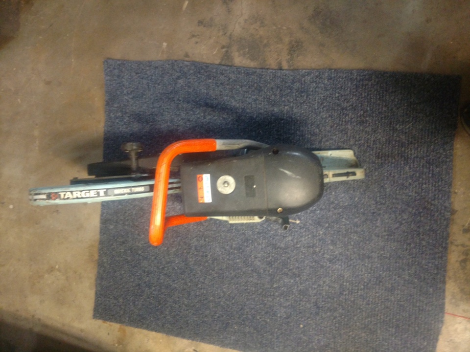

Target cutoff identification?
67L36Driver
11:23 AM
596
9,400
39,363

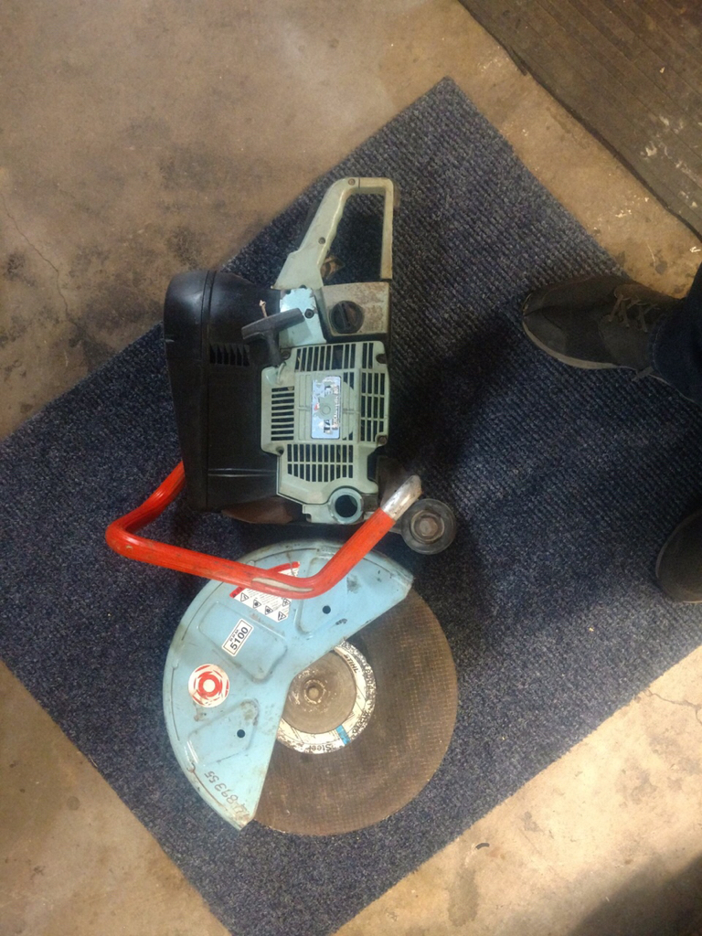

What make/model saw is the same?
Needs a flywheel as a starter dog post is broke off. [emoji90]
Solo fan
9:23 AM
8611
Feb 1, 2019
27
69
Taos Missouri
Emak is the main company. If it’s anything like the older Hilti saws that I use to rebuild the crank seals and topends from Efco chainsaws will work on them I say Efco because we had a dealer near by so that’s what I bought, pay 230 for 981 top end or pay hilti 460 for the same thing Like Jacob J said looks alot alike because they are identical besides the top cover and obviously the filter set up. ICS target hilit clipper are some of the companies that come to mind who used Emak concrete saws.
