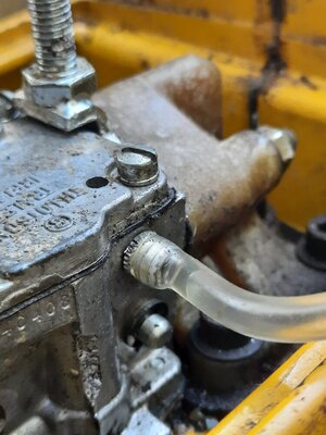

I was able to remove the plastic elbow and just barely get the new fuel line to slip over and stay on the the nipple that is sticking out of the carburetor.
The saw fired off for a few seconds after squirting a little gas down the intake, but it won't stay running. I suspect it needs carb work and whatever pulls the fuel from the tank to the carb might be malfunctioning. The line from the carb to the pickup is clear and I have gas flowing freely from the tank to the carb fuel line when the nose of the saw is inverted and the line is off of the carb. There's a bubble showing in the line in the photo because I had just disconnected the line to make sure it had fuel in it. I know nothing about these carburetors.
I pulled the plug and checked for spark earlier and the plug looks pretty good.
Also, this saw has a ton of compression. It's really difficult to pull over without using the compression release.

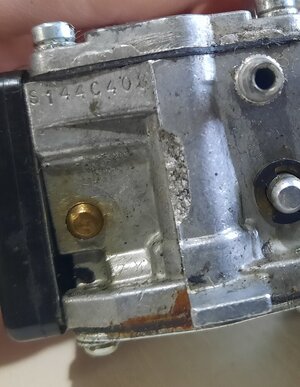

Here's a photo of the number on the carb. Can you tell if that's the correct kit from this number?
You can also see the little fuel boss sticking out that I'll have to replace with one that has an elbow. .
