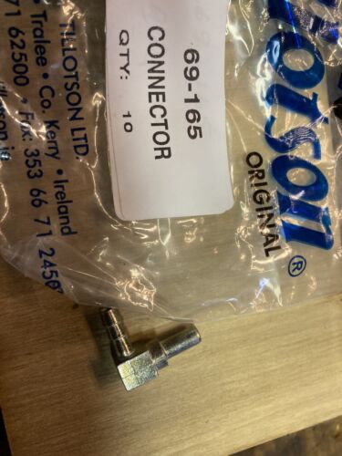

Believe this is what you need
That's the one I'm ordering.

A quick update. The slide hammer worked like a charm after I threaded the nipple and inserted a 6-32 screw.
I've got the carb kit in hand and the new elbow will arrive tomorrow.
Is any sort of sealant needed where the elbow presses into the carb body?
