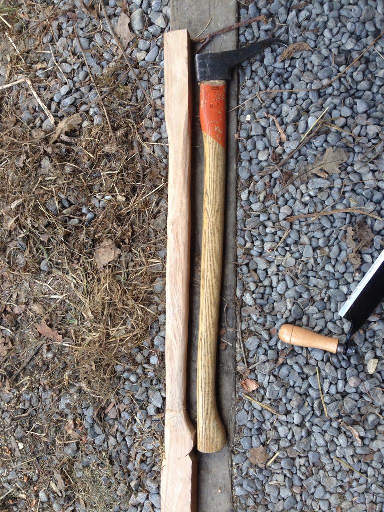

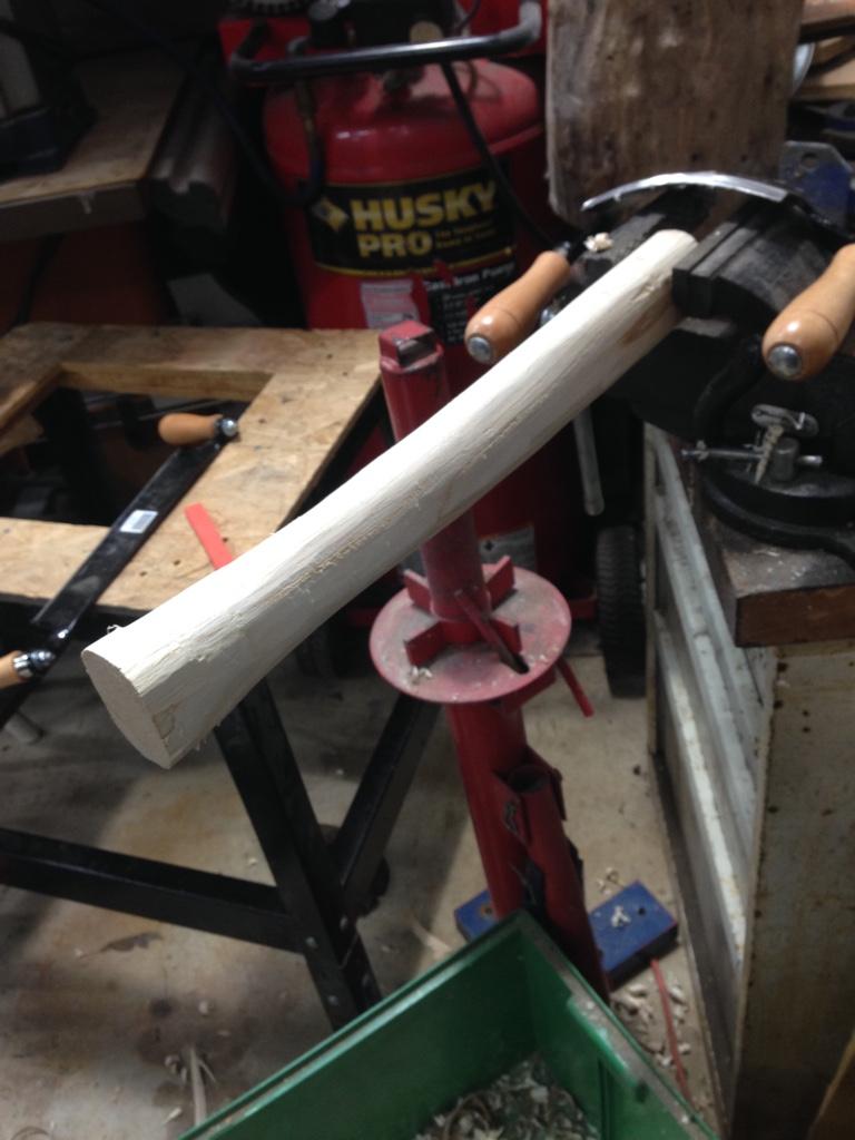

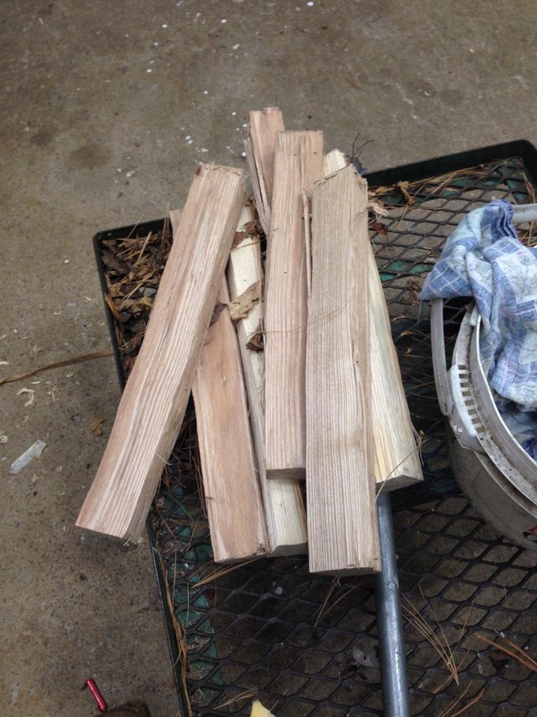

You guys made me do it.
First time.
7:00pm
7:05
7:10
7:30
7:45

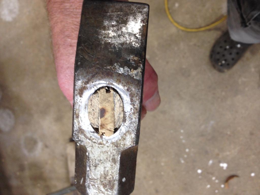

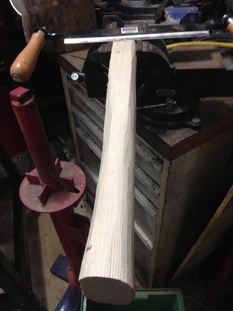

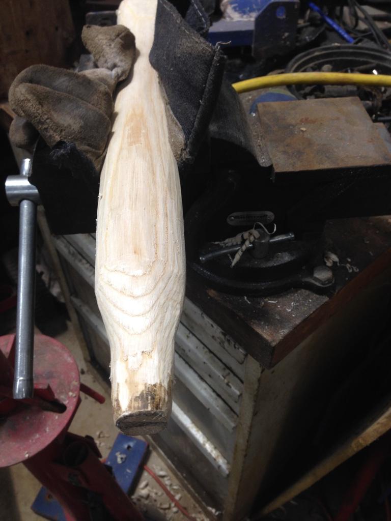

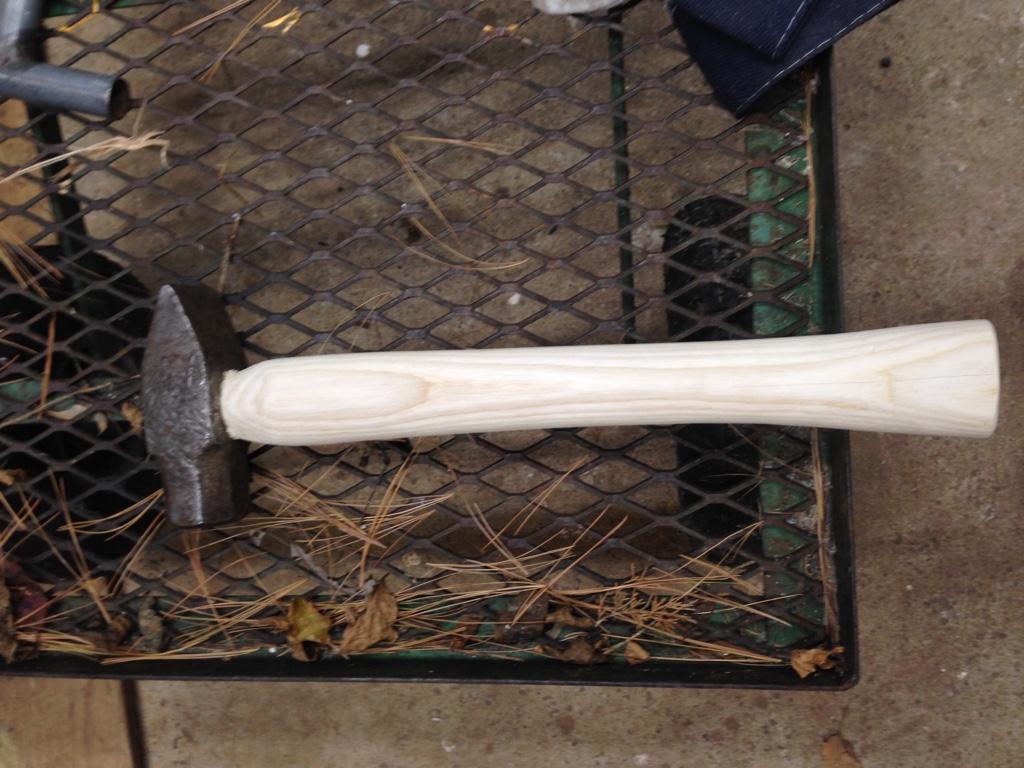

8:00
This started out with an unbreakable fibreglass handle
Now it is ash.
Not fantastic, but not terrible for a first attempt.
I’m in trouble now. A quick look in the toolbox found 2 axe heads and 3 more hammers needing handles. :)

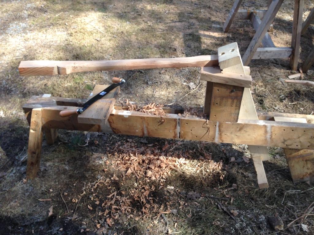

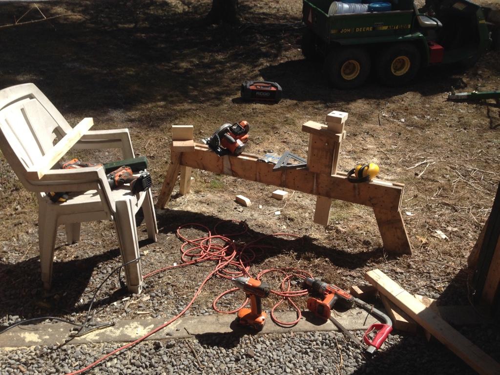

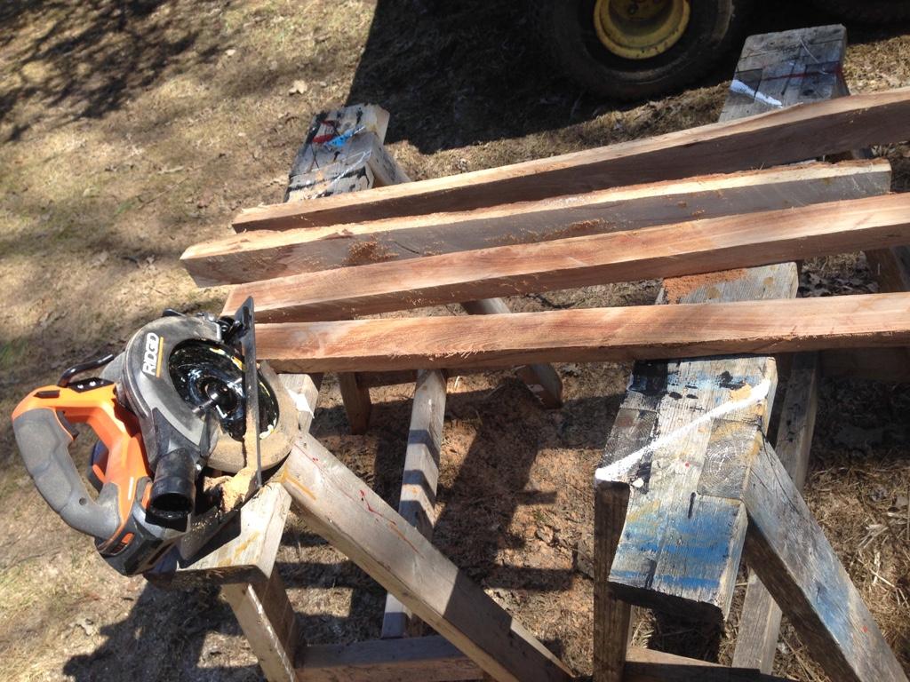

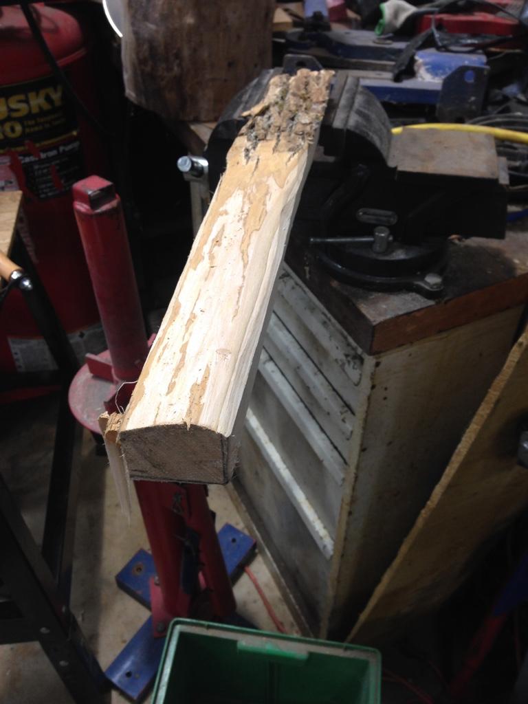

Had some time while I was watching water boil aka making maple syrup so I thought it was time for yet another handle. I don’t have a bench in the sugar house, so first up was somewhere to sit.
Then I ripped some strips of hickory. Very impressed with my new cordless circular. Ripped 3” green hickory without complaint and I made 4 40” cuts on the 4Ah battery and it was not depleted.
A bunch of draw knife work later
The first one ended up with a small knot where I didn’t like it so I made a second. They both still need some smoothing and then drying.
Good work. Nice wee set up.
Decided I'm going to plane my lengths of timber before I make my next one. I had a knot right where I didn't want one on the last one I started, like you did. Because of the rough sawn timber it wasn't until I got to the finishing stage that it showed up
