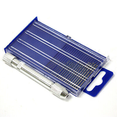

Didn't know that about the threads on the cap! I went ahead and ordered a .020 drill bit. This bit is so tiny and the jet is just brass, I figure I could just use the bit by hand like a little rat tail file to enlarge the hole.
Larry B
7:33 AM
3952
Sep 2, 2017
619
1,808
SW ohio
These are handy when working on mower carbs
