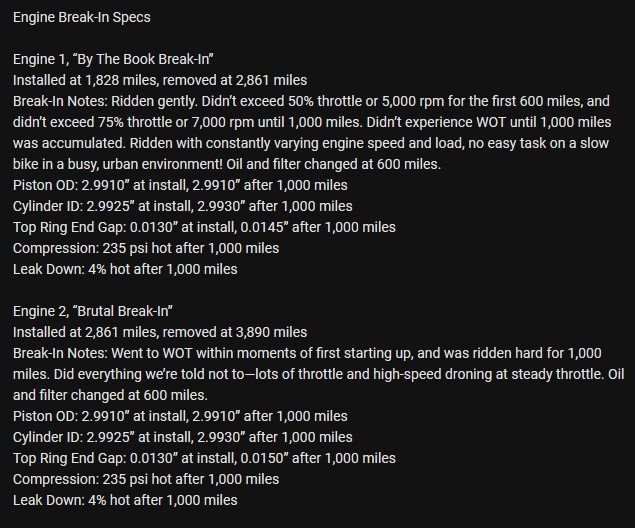

I found this interesting. They tried to do two completely different break-ins on a motorbike to see how it affected the engines. Yeah, it's not a two stroke, but still interesting. Aside from the ring end gaps, they were nearly identical after 1000 miles. The ring end gap is not really a surprise. But it is interesting to see how it made little difference otherwise. They used Bel Ray oil.

Imagine all the fun missed by the rider of engine #1 babying the bike. No thanks! The best an engine will ever run is right after its rebuilt so enjoy it while it lasts!

One thing I did read and never got the chance to try was the difference between using WD40 on the rings vs motor oil.
The old school method I heard was to coat the piston and rings in motor oil during assembly.
The new school way was to lightly spray the piston and rings with WD40.
I guess the thought was WD is thin and allows the rings to bed in the cylinder wall faster. The thick motor oil doesnt allow the rings to make contact with the bore and can glaze the bore. I guess the oil in the ring glands can carbonized and also cause ring stick.
I can't imagine that any kind of assembly lube hangs around long enough make a difference either way with a fog of gas and oil droplets being sprayed everywhere.
