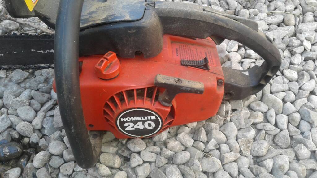

Had a friend drop off a few saws that he couldnt get going. First one poulan 3300 needed new gas.
Second cheapy newer poulan intake was loose sucking air.
And my favourite was the last one. Little old homelite. Figured i might as well start by dumping out the old fuel. Started pouring and nothin but bar oil in the gas tank and the bar oil tank full of gas lol. Never had this befor so thought it was kinda funny. Im sure you guys and girls have had lots of stuff show up like this.
So have you figured out what's wrong with the Homelite yet???
Put bar oil where the gas goes and gas where the bar oil goes.
Havnt tried firing it up yet but im sure i will have to pull carb to clean it out. Plus im out of gas too. Gotta get some today so i can try it.

Put some fresh mox in the little homelite. She fired rite up but has an air leak. Tip it on its side and it starts leaning out.
Not sure if i can get seals for it or if its worth fixing but up to the guy who owns it.
