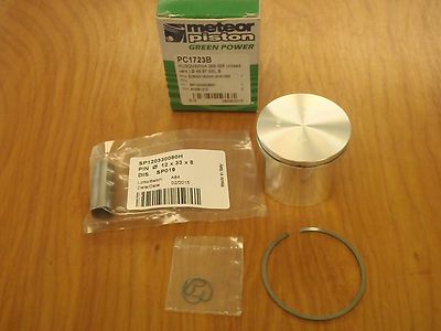

I wonder who makes closed port 266/268 pistons anymore
I'll build another one.
Hutzl and Meteor have them.
That's the farmertec pistons i used in my saws
I'd like to find a full circle 266/268 piston that's lighter than a 372 piston.
I have a windowed one but I don't think it's lighter than the 372 piston. I'll weigh it if you want.
