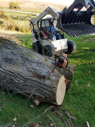

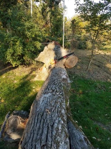

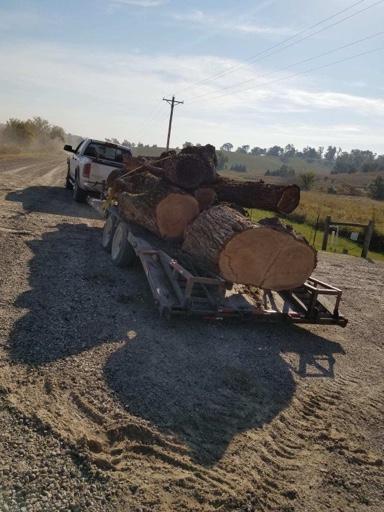

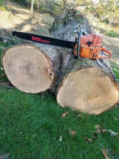

Hooray 288
Give it a workout this morning
Neighbor hired me to get rid of this oak
Sent from Hoskey hilltop
288 been ported?
