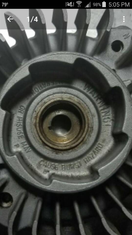

This is the coil and flywheel that were on it. It ran good before the rebuild no kick back while starting, only had a problem idling down when tipped bar down.

I went through the carb last night got it back together started ok but still pulled hard and if you don't catch it right will try and rip your arm out of socket. It was idling better turned to grab a screw driver and it makes a pop / back fire and quit. Sounds like timing to me so I pull the flywheel and it sheared the key off.

So the ide prob is or was down to the oil seal ? Did you take the flywheel off and not put it on properly? I’ve done it , twice once the key sheered the othe it chewed the fly wheel.
The carb may have been adjusted to compensate for the air leak, that’s why your getting a kick/more compression
Check and set the carb to std settings
I did notice your flywheel has a p & b marking but only one key way, you need the part # of the flywheel and coil an check that sticky, but something tells me you only had a tick over prob so a miss Match is unlikely

The idle problem from before was from leak. It dosen't idle well now but it has no leaks. I pulled the flywheel to check the alignment/key after the first starting because of the kickback, just to check it. It looked good so I reinstalled it.

It did run good before with the flywheel and coil combo. I am however not sure if the flywheel was aligned with the keyway when I took it off before I did the overhaul. Could have been installed /aligned off the key way before, because the key that was in it was filed down so I put a new one in it when I put it back together.

Ok next question what do I need to get? Different flywheel? Or can I index the one I have?

Ahh, I,m glad that the boss has stepped in and said you basically lined it up wrong.
I hope you know what to do now ? ;)
Edit: it took a few q's to get a few answers, so now you knowhow it was before you took it apart, with out looking too close at the time

Line the keyway up with the "B"
It's a single keyway 1204. They are always limited....he will need a 1201a or a dual keyway 1203 or 1204
Or have you broach one, lol

He'll have to sorta guess at the "B", but, with a little luck....dot dot dot
