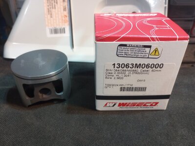

Show us your CCC Racing Wiseco Piston and tell us a little about your build, be it a racer, milling or work saw
I'll start out with the one that I just received for an 084 resto-mod work saw project that is in the works with lots of new and NOS parts, metal refinishing and a woods ported. My thoughts are that the lighter piston will allow it to run harder longer, well at least that is the theory anyway...
