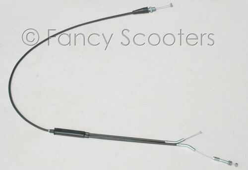

@Willard - dude nice! Pumper carbs help a lot for lightning fast throttle response. I wish I could find one small enough for my little clone 110 pitbike I have been playing with. I think I have it just requires a throttle cable with a split into two at the carb end to run the pump. It’s not set up with a lever system to run the pump.
legdelimber
12:13 AM
8391
Jan 14, 2019
860
2,185
N.C.
Just a half formed thought here.
A number of motorcycles ran a throttle cable that needed to have the one cable at the throttle/handle bars and then have two cables at the other end. (at least in the 70's era)
One controlled the carburetor and the other controlled the oil pump.
You might see if someone has the "splitter" section for sale in old bike parts?
Or is this cable set up used in the hot saw stuff?
edit: here's the first one that popped up on ebay for me.
Maybe this will help get ya into the catagory and find a usable kit?

Funny you guys mention split throttle control for oil pump and carb.
I've been running that setup on my hotsaws for over 40 years.

@Willard - Wow that works perfect for you since you are running a pressure system for the bar oil. Simple and I assume it would work extremely well. Do you ever adjust the psi depending on what wood is at the competition or maybe temperature?
@legdelimber
Hey thank you very much! That helped! It led me on a path to finding some cheap overseas copies to try out first to see if I can make something work.
