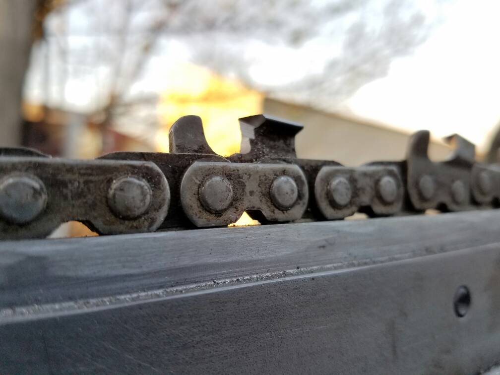

I thought I might be the only one who filed a chain in a hotel. I took some with me to practice on a few months ago. Of course they are round filed for firewood and actually could cut butter. After the bar warmed up. :roto2lol:
