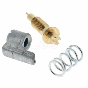

If I was to bond an aluminum limiter cap to a brass mixture needle, which glue would I use?
E D I T : Nevermind. The service manual says to use Loctite 638. I'm very surprised the service manual would say that. They even say to back the mixture needle out 2 1/8 turns from stop.
