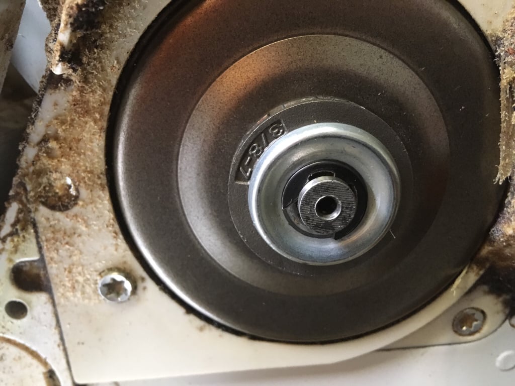

I’m not sure which pin sprocket the saw had on it.

Was that a 7 or 8 pin?
8 pin 3/8 round file
My saws run 7 pin. (Unless it was changed).
Looked like Doc had an 8 pin on it.
Maybe Dan can check for us. I remember seeing 8 pin.
I'll know when I put a bar on it Upstate NY.

That beast needs a 8 pin on a bar that size huh. 9 would probably be easy for it too, but hard on the clutch for work.

We will leave the 7 pin, go with 36" full comp, and drop rakers if we want!
It seemed to cut pretty fast with a 7 pin, and I like torque.

The 7 pin could explain why it was running strong. Never lost any power even when I leaned on it.
Prefer a 7 pin for work unless it’s my ported 395. Run a 32” 8 pin setup on it currently. 8 pin keeps it loaded a bit better on 28” and 32” ....36” and up I would drop to a 7 pin to be easier on clutch.
