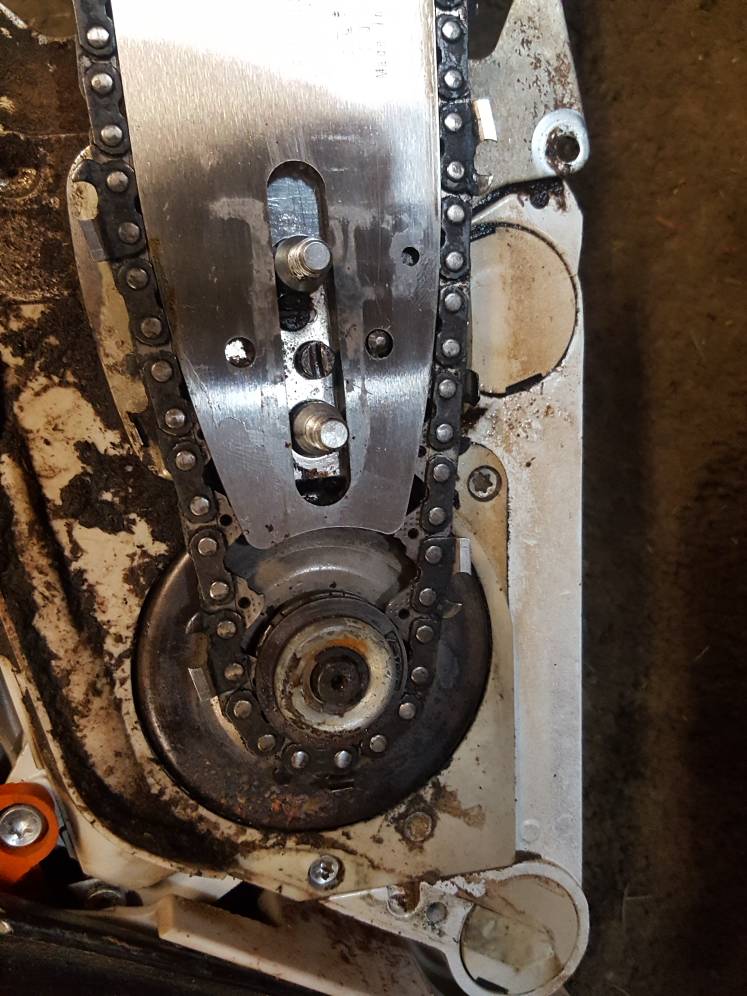

I was hoping you would chime in. The bar is here now and I will get pictures tonight. New chains leave less adjustment than what you are showing. The first used chain he tried to mount comes no where near tightening up. I will up date pictures tonight.

Cutting the slot would fix nothing...I would have to redrill another adjuster hole too. The adjuster is getting full travel. It is as if the bar and tip profile is narrow and leaving extra chain hanging off the tail. Saw is here for some other tweaks ... will get pictures tonight.

Dropped a DL off these Stihl loops and they fit much better. Annoying the 105dl bar is more a 104 dl....
