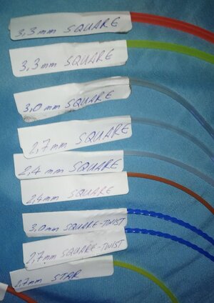

Get true square, non twisted.
It is/was a game changer for my application.
The water thing doesn't work for me for whatever reason.
Watered lines tended to snap exactly at the outlet eyes of the line heads for no apparent reason.
Stopped watering lines and the issue vanished.

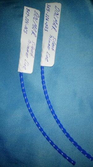

Blue Dolmar "Silent" line likes to weld onto itself within the head.
It is true square line with very sharp edges, twisted at a high rate.
It cuts like a razor blade though.

For me Square & Star (Husqvarna) profiled lines do not self weld - the twisted ones do.
Round lines are just "meh", most universal but painfully dull.
Sharp edged profiled lines feature increased performance.
This Dolmar line is like a razor blade, unfortunately it likes to self weld and so far I found no remedy.
For the stuff I have to knock down with my weedeater I just go ballistic with sharp edged true square line 2.7/3.0/3.3mm (.106/.118/.130") gauge flat to flat.

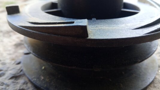

But, I have to try using these Dolmar lines on the heavy duty head I came to love as its drum features a barrier theoretically reducing friction as the wound line halves no longer touch spooling off. 🤔

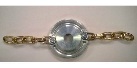

In about two months when my sister comes visiting again I'll be having a chain flail head! :thumbup:

I think I'd want some shin guards with that chain head. Keep a close eye on the bolts and holes each time when you refuel the trimmer.
I wonder if it throws rocks any harder than trimmer line does? Somehow I'm thinking of a chain link transferring nearly all of its inertia to a stone.
Bottom line, I'm pretty much for running whatever works well.
Just saying to keep an eye on it for any cracking or stretching or wear that could be an indication of approaching failure point in its usage.
4:30 PM
14,112
55,770
Those monstrosities are Italian design & made.
They are technically illegal in the Europe Union exactly due to severe injury risk.
My sister got one over a decade ago, cleared a brush patch for her honey bees.
I tried it once years ago, it smacked 1" OD wild hazel brush to pieces - and YES, those hazel pieces hitting my shins hurt like hell.
I am thinking this might help a bit to protect from major injury.

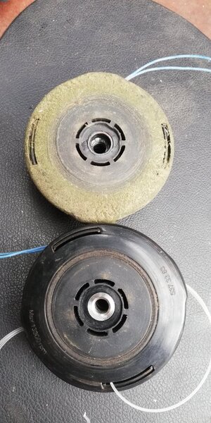

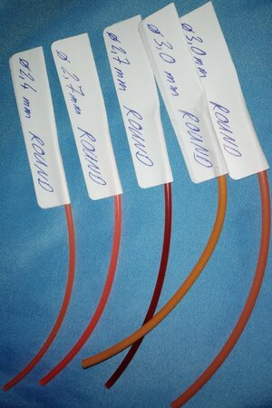

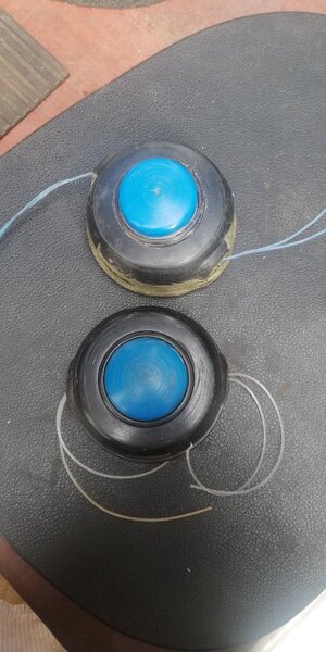

I only use Stihl 2.4 round with no problems. I have some 1.5mm string left from an electric trimmer 😎👍 T25 Original and Chinese
