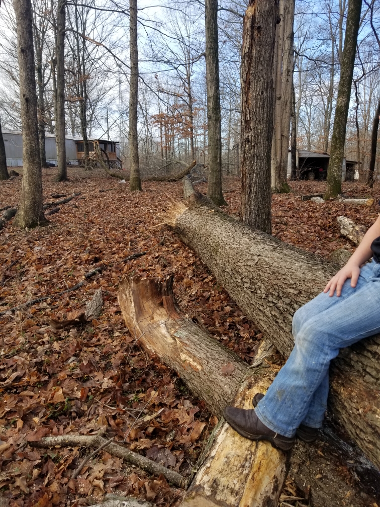

1577186918244-1465695567.pngHere's an up hill leaner That was fell through the intended hole to the right. I didn't notice the rot from a small undercut. Perfectly green with no heart rot conks. It had the split that heeled together but oxygen exchange prompts rot.
I cut from lookers veiw (hikers veiw)
I dogged in the back and then would have dogged in the mouth and pulled but as I was adjusting on the fly coming around the back when I realized what was going on. I just laid the pressure on until it started to fold and got outta Dodge.

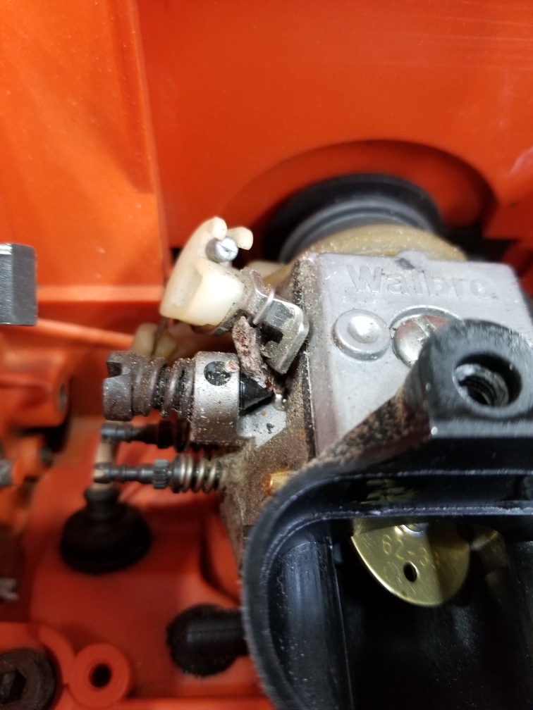

And I'm pretty sure I smoked my 372xp. Was cutting with it when all of a sudden ,wide open throttle with no response, had to shut it down with switch.

All mine are routed to the airbox with the little echo vents. It starts right back up, but goes straight to wide open throttle, and the linkage and all is working properly. I'm just guessing an airleak has developed. Lol and yes we were in tshirts, was rather warm in Tennessee yesterday, got up to 65 iirc
If it starts and goes straight to wide open and it's not your cable frozen or what not, then it sounds like the cylinder could have lifted.

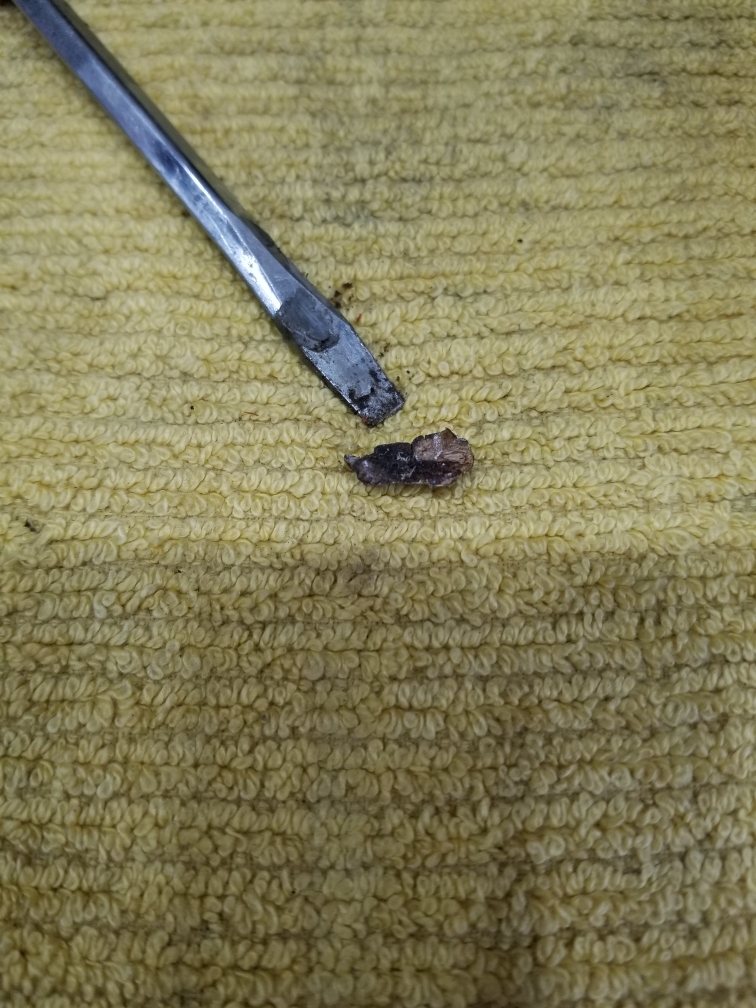

Found the problem with the wide open throttle, piece of bark stuck between the stop screw and plate
