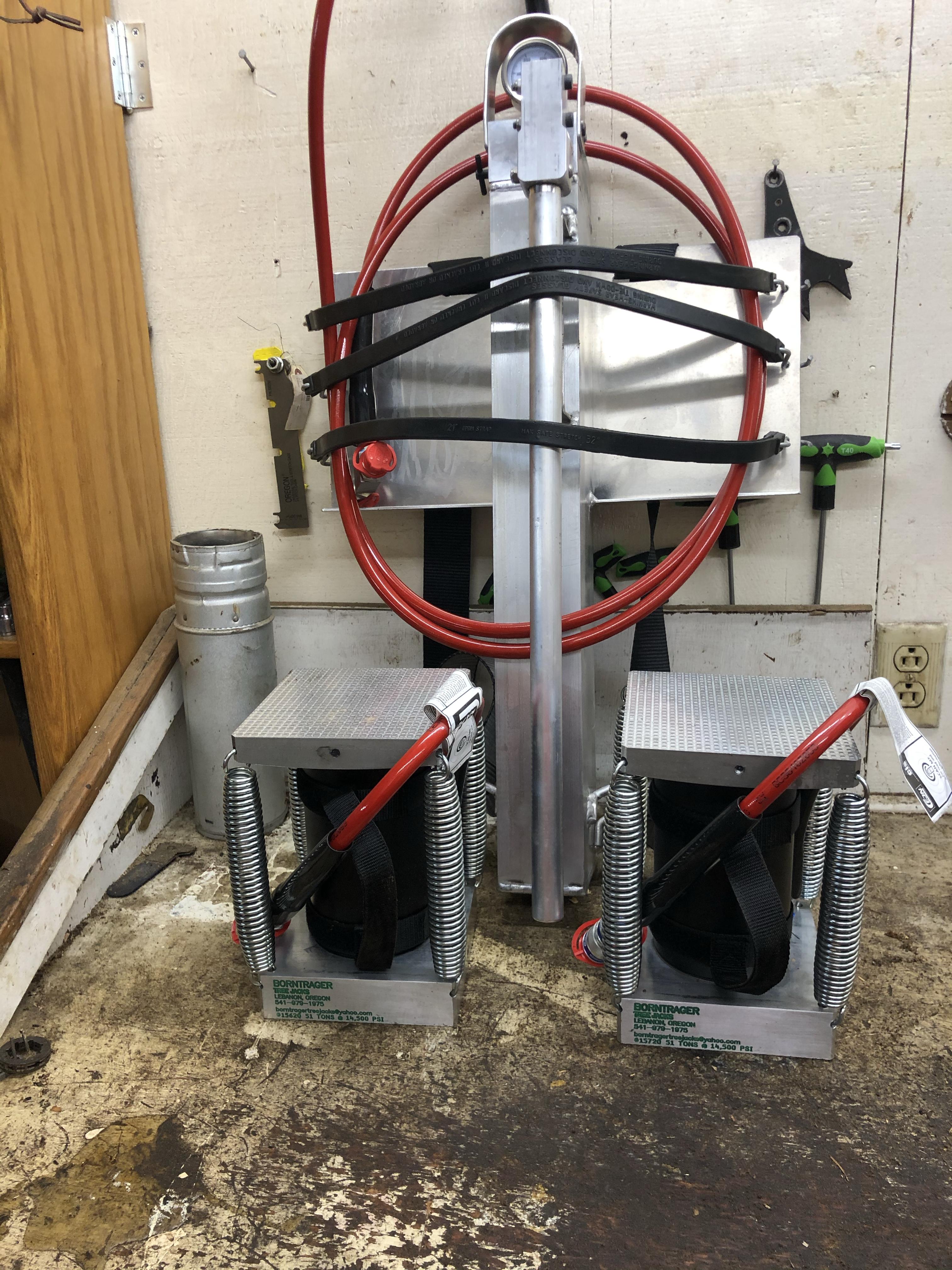

Are they the old Silvey tree savers or the little fellers?

You dirty dog! I’ll test them for ya!
I’ve got a few big ugly girls that only have one shot that really need to get put to bed to test drive them on. I do like how they made a few changes no more plastic wear plates and a few minor things like that.

That's the fanciest set of jacks I've ever seen...
Those Silvey sets were pretty always pretty fancy when sitting in Madsens and from memory these are cheaper then the Little Fellers were at the end.
