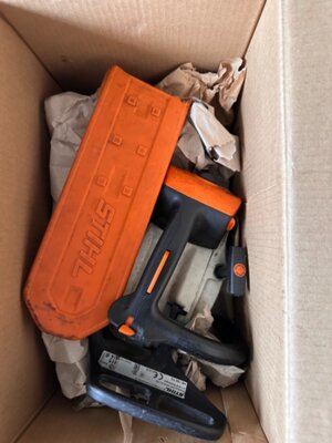

I thought I,d rekindle this thread with another Ms150tc 🤷‍♂️
The shorts is . The last one went to my son as a xmas present. And I got the urge to replace it with another one 🤦‍♂️
This vid is the first startup after receiving it today..

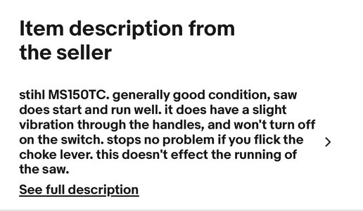

I will add the listing said, it vibrates and stop switch don’t work but works ok.
However this seller I believe mabe a dealer and has taken this saw in px, the reason is it came in a stihl box
However, the tickover (slow ?.? Not checked yet) it seems lumpy/ knocky.. and while running half to full throttle it’s not smooth as it should be.. it does stumble on acceleration
I have my ideas,, but would like you lot to chime in on what you think from this short vid

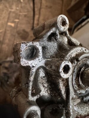

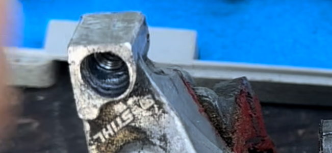

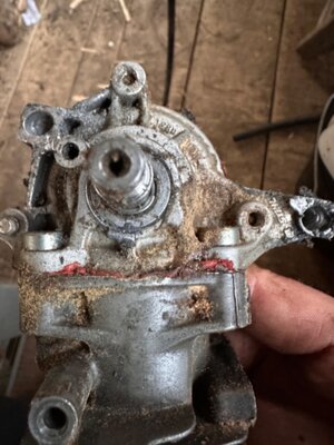

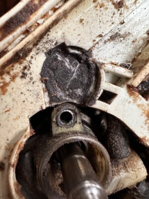

Maybe this one will need a new/ or sh crank case . its wallowed like nuthing I’ve seen before 🤦‍♂️
Anyway movin fwd, it’s apart and now needs a good clean. have not taken the cylinder off just yet . As I want to get a squish reading. I think someone had been in there due to the dirco on the base gasket.?
The pic's…

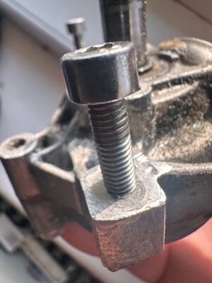

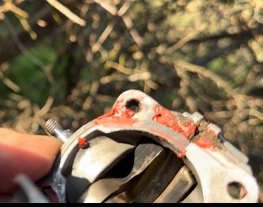

Some poxy stopping the bolt fallin out and stop in the off switch earthing out 🤠

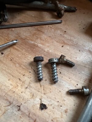

It took a nail and hammer to knock it out so I could get a torx on it but I didn’t need to actually undo due to the shortness and wallowedness😝
The wrong and way too short bolts, you can see the poxy on the left hand one.

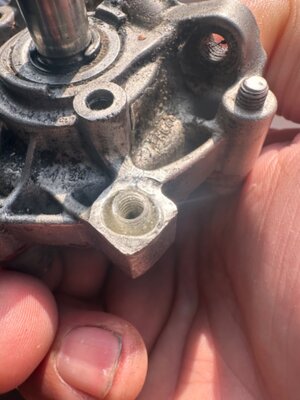

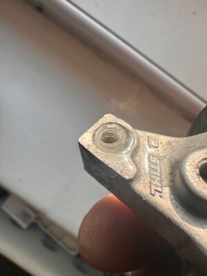

Here’s a bit of an update on this saw.
It definitely looks like someone has been in this saw before. I'm not sure why ?
It could be the crank case half has been changed as its a different colour. However whoever put it back together used the the wrong bolts which failed in short order.
The saw was run pig rich for some time and there is carbon on the crank lobes 🤷‍♂️ and some carbon on the front of the piston as well as some behind the piston ring (I haven’t got a pic of this) but I will do
I ve helicoiled what’s left (about 1/2 way) on the engine mounts and I’ve fitted some bolts with some Vaseline in the threads. Then poured some runny epoxy to fill up the void . I'm not sure how long ithe epoxy will last, but I do think there is enough meat in the case threads to hold it in place

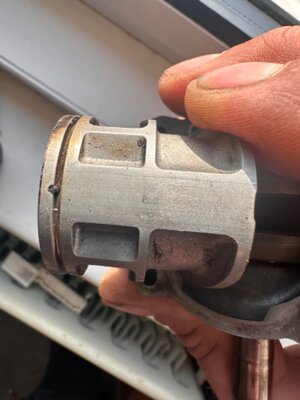

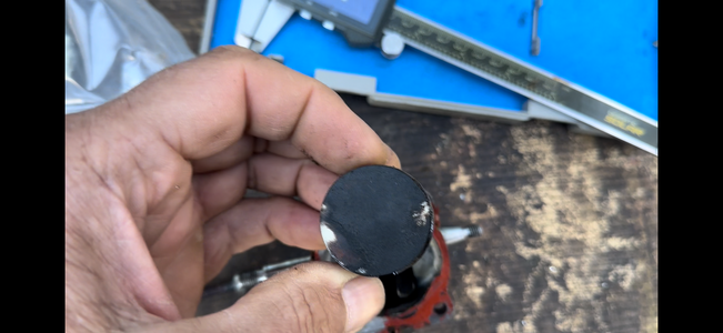

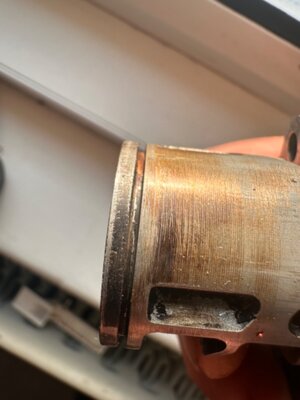

The epoxy isn’t fully cured yet,I think it’s been just about 12hrs. So I’ve taken the opportunity to undo the bolts I used and sand down the excess. Although Not fully flush just yet.
I’ve started cleaning the piston and got a pic of the front & back. The back has some wear but not as much as as the other 150's I’ve done. However it’s puzzling me as to why there’s so much carbon in this saw.
You can see there is some in the ring lands and down the front but it’s the build up in the windows/front sides of the piston as well as the crank lobes. I can only guess wrong mix at the moment?
